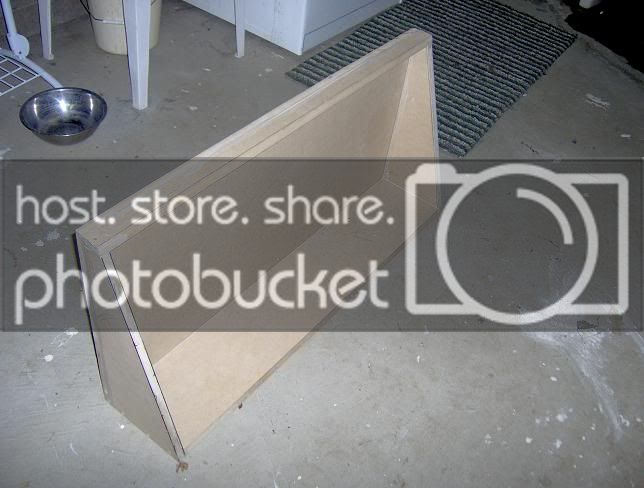

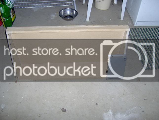

gogo req. The box is a wedge. I have both amps temporarily wired up all temporarily and the like. I would have bass but my RCAs are busted, all for connectors somehow. So tomorrow looks like this:

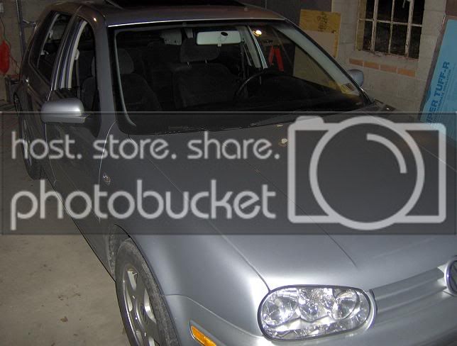

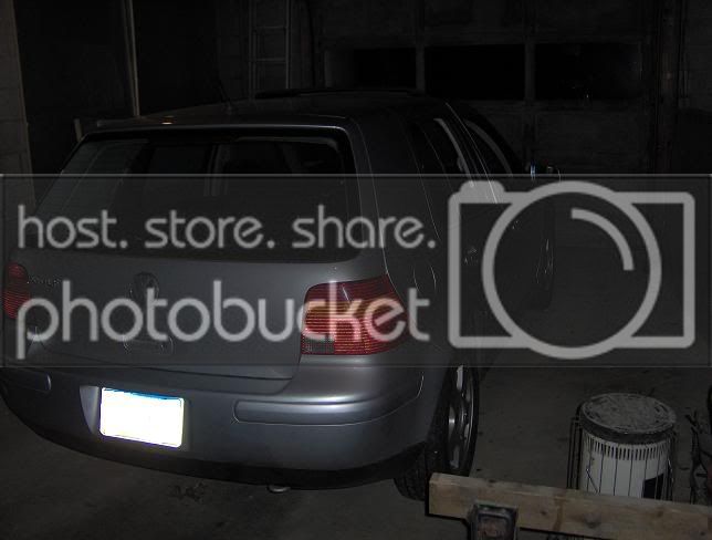

The car - best shots I could get in my garage:

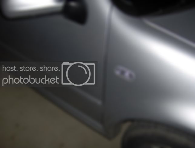

^ my 900 scrape. good thing it was the other guys fault.

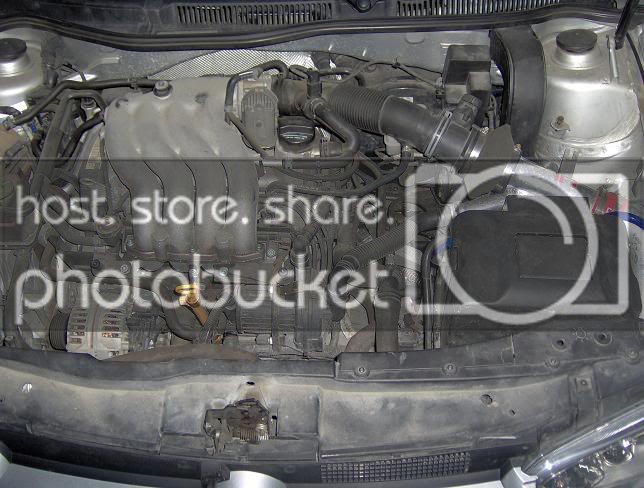

The CAI was $20 at a junk yard. It's cool tits. I wonder if I can find a 8v short runner intake?
The brown shit is chocolate. I have yet to clean it out... It was the girlfriends... heh.

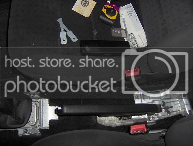

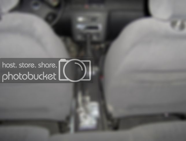

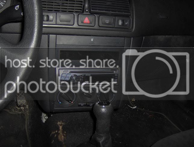

I am going to fg a new center console holding ONLY the shifter boot and cover for the e-brake. I am leaving the center as open as possible.

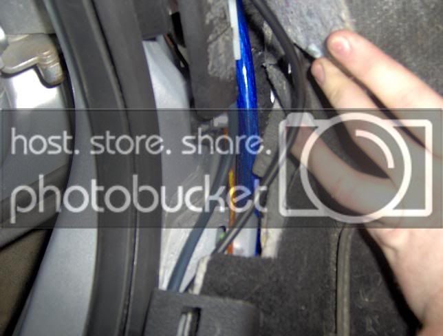

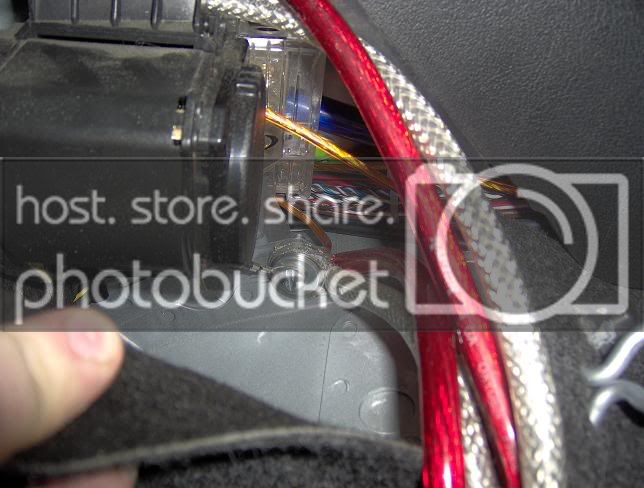

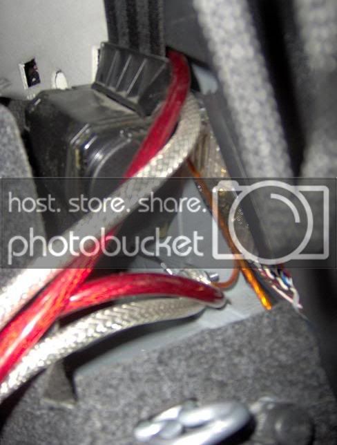

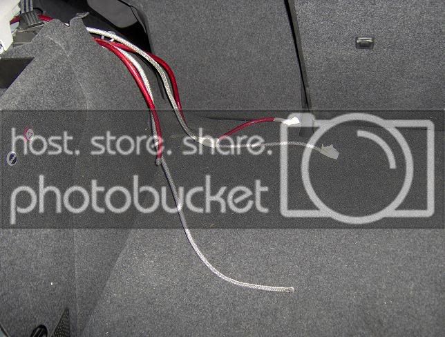

I was asked where the ground was and how long the ground wires were. Well, here's your answer. Here's the ground and distro:
The ground is as follows:
bolt head>small washer>h701>large washer>4agw>large washer>4agw>large washer>head unit>medium washer*>sanded metal>nut
* = I used the largest I could there. There is a piece of metal that comes up near the hole and meets it. I wanted to use a large washer but it was too big and didn't sit flat. With the smaller washer, I was okay.
The untaped wires are the ground. The siver is longer than need-be. It's not cut to size, yet. All of the wires will be encased in black split loom and mounted removeable style to the hatch pannel when I'm done.

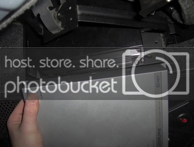

In case anyone was interested, the h701 indeed fits in the stock monsoon amp holder. The connectors have to face the door but that's not a problem, really. New holes need to be drilled, but again, not a problem. I test fitted with the amp out, just no pictures.

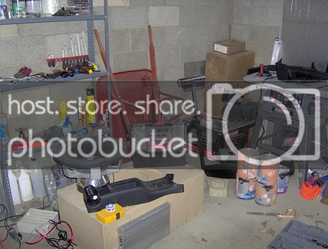

and the "goods" - upsidown shot of the sub in a temp box:
and it's new home:
Good stuff Mr Pwnt. Thanks for pointing out the ground to me....I actually might try that same thing. Man I miss that sub...she sure looks pretty //content.invisioncic.com/y282845/emoticons/naughty.gif.94359f346c0f1259df8038d60b41863e.gif
Fox, my initial impressions with the sub are less than stellar. Sure, the sub was the only thing playing and I probably didn't have any of the settings right but she was getting 300w per coil with the temp box in the spare tire well firing up. I saw her move (more than I expected which suprised me) and heard a lot of motor noise but not a lot of bass. Like I said, probably a wrong setting or something. Hopefully I'll get to play more with it soon, and get the monsoon integrated throug the h701.
