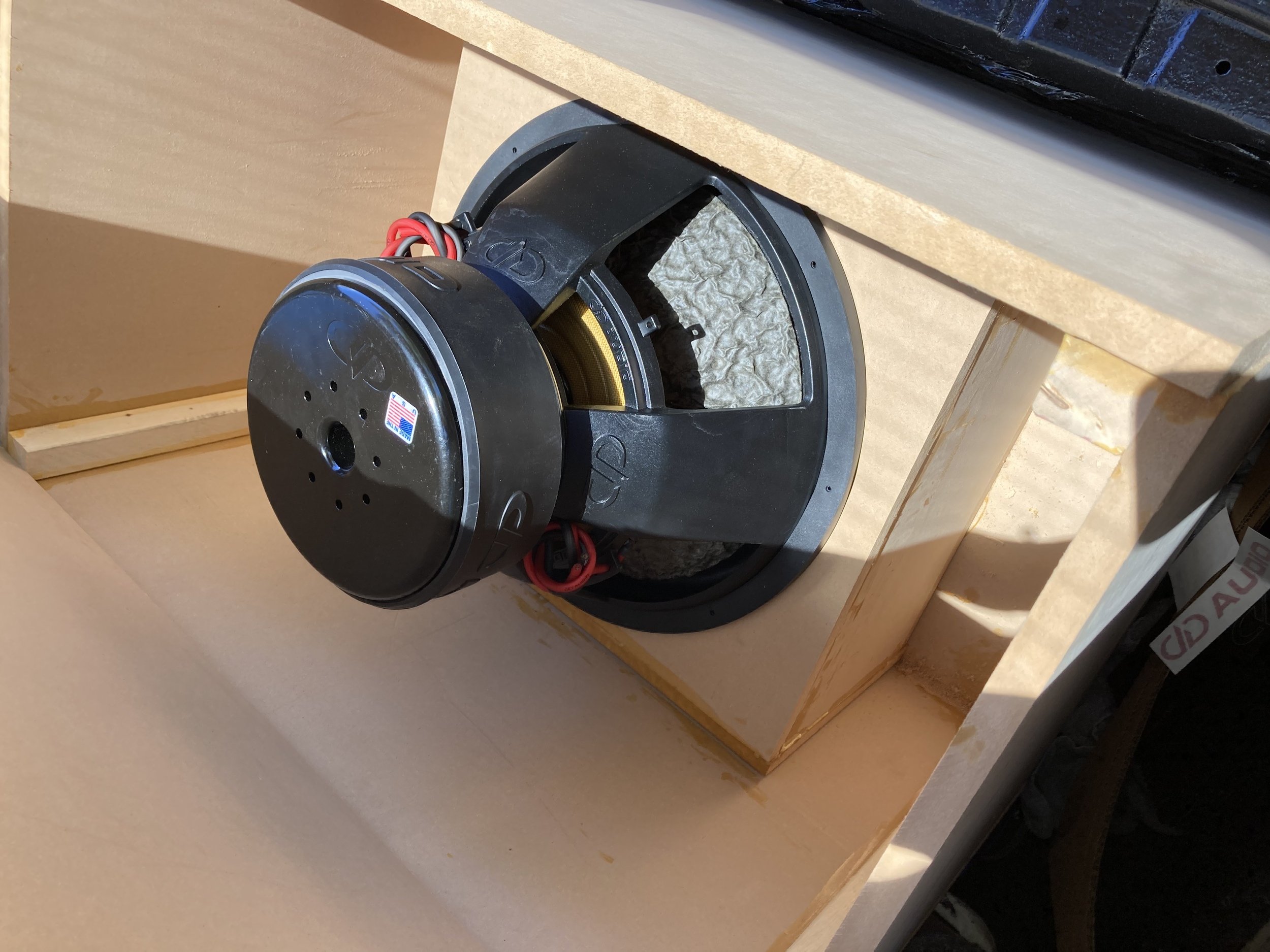

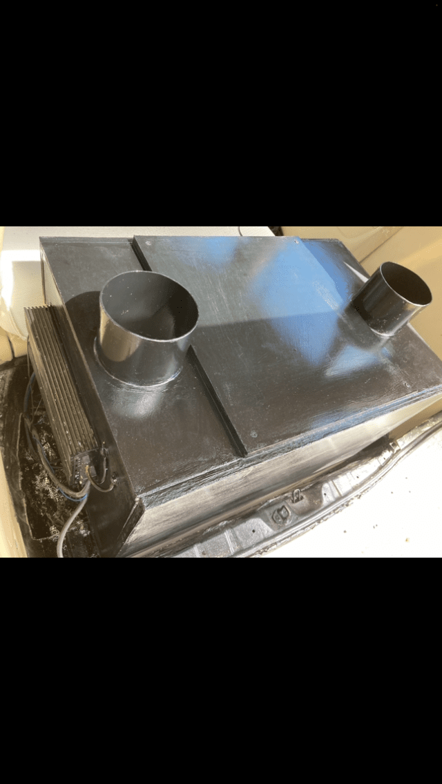

A. Try inverted 18” Passive Radiator and the Ports.
B. (1) Single 18” Passive Radiator.
C. (2) Dual 18” Passive Radiators. Normal mount.

This isn’t going to work very well unless you’re very experienced at designing and building. If you were to try it, you’d have to match the amount of air the ports displace exactly to the amount of air the radiator displaces. VD. You’d have to design the box as if it has 3 ports of exactly the same size and length. The 2 ports would have to be sized exactly to the amount of air the radiator moves and tuned as if there are 3 ports in the box. The radiator would then be weighted and tuned to match the ports tuning exactly. It’s not that it can’t be tried, but I’m not really seeing a reason to do it. The 2 ports are already taking up space in the box, so the space saving benefit of using radiators is already moot. You’d also need to start from scratch and build an entirely new box. Modifying an old box with a radiator is not going to work.
I think if you could even get it tuned correctly, you’ll have cancellation issues, because the radiator and ports are going to reproduce frequencies differently even while tuned the same. I would stick with one type or the other.
Why would you consider using ports and passive radiator? Just pick one and work with it.

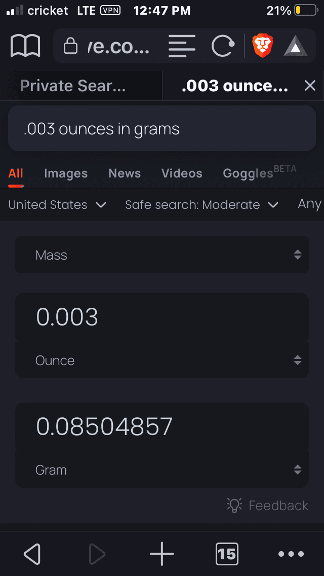

The weight of air volume in both ports is .003. Ounces.

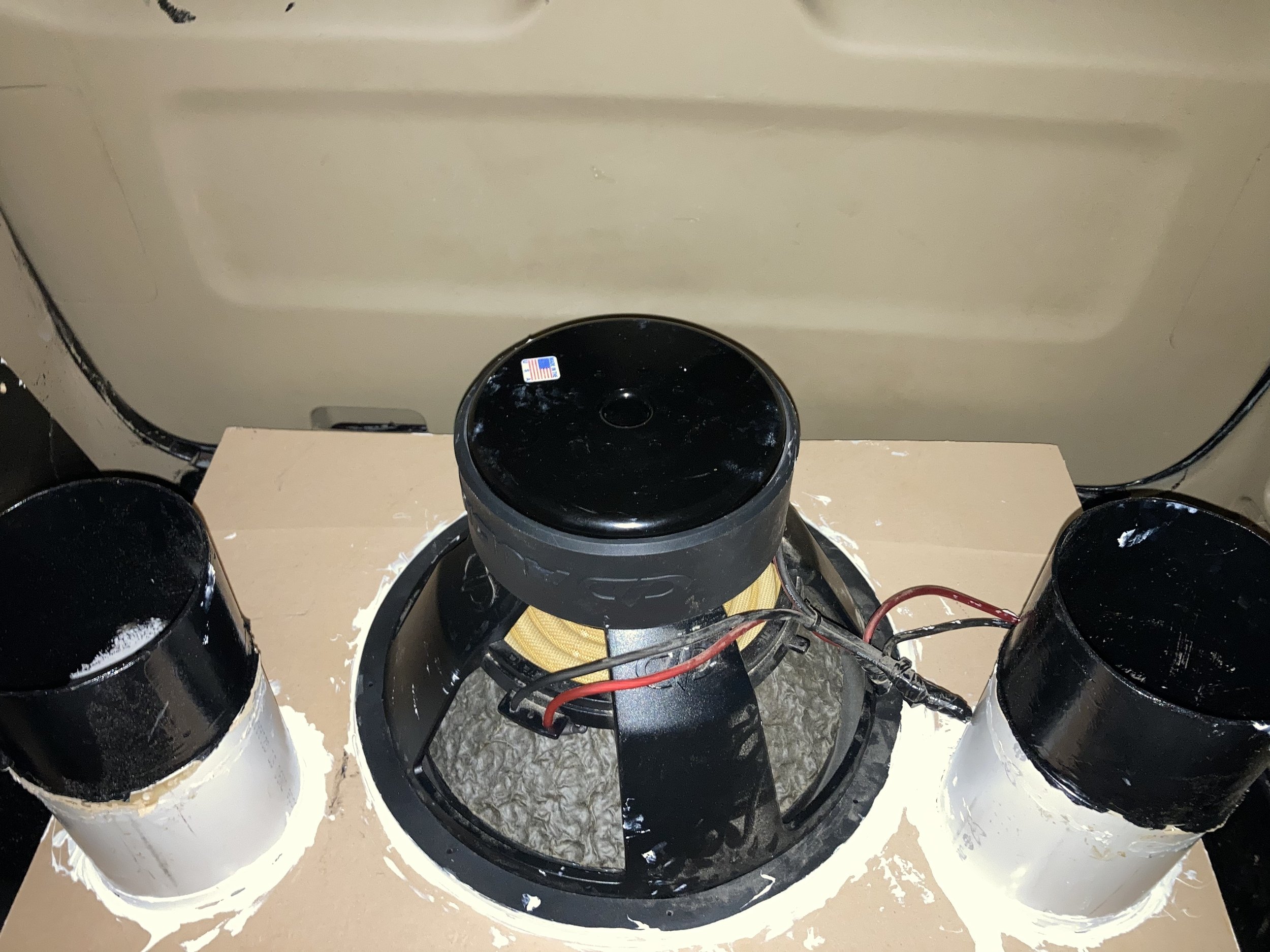

Agh 3:1 experiment. Wasn’t counting on anything.
I’ll stick with the Bass Reflex 33 HZ for now.
You're not trying to figure out the mass of air in your 3" port or whatever, you're trying to figure out the mass of air that you would need in an 18" round port for your desired tuning since an 18" port tunes by vibrating a column of air of that mass.
Start over by entering 18" round port into your box software and determining the port length required to get down to your desired tuning. Your mass is going to be closer to a pound assuming your box volume is 6 to 7 cubes or thereabouts.
