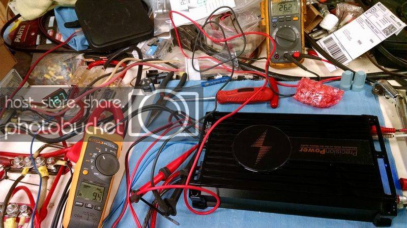

I have been abusing my new PPI 900.4 for over 15 hrs now on my test bench. 45 min full tilt, and the rest at 3/4 volume, like 5-6 hrs straight at a time. I have channels 1+2 on a set of cheap 6.5" 4 ohm coax's, and channels 3 + 4 on two 2 ohm 15" subs. All I can say, is this LITTLE amp is pretty awesome.
I have the front set at around 75 rms(because that is all the cheapo coax's can handle), and the rears at 240 rms, at full tilt. And this amp has yet to get more than slightly warm.
http://vid1241.photobucket.com/albums/gg515/gotgixers/PPI%20cars%20that%20go%20boom.mp4
If you watch that vid, it sounds like total crap. But that is just because it is recorded with my phone....lol...it actually hits pretty hard in person, and is not distorted like it sounds on this recording. you can see how much it is moving the 15's ....
