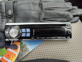

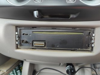

Can anyone help I can not remove my Alpine radio from a Mitshibishi L200 pickup.
The radio has power but will not tune and no output to speakers.
Whats the procedure to removing it please. Photos attached.

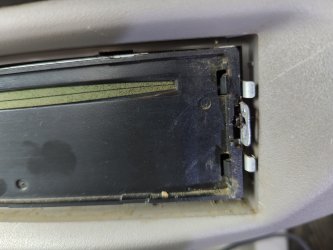

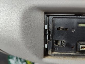

You'll need to search for the ones that may be model specific but you need a set of these to get that unit out.
They get inserted on the right and left side slots like the left side pictured here:
Inserting the keys depresses the retaining clip on the side of the cage and allows the unit to slide out. Make sure to query by make/model to insure that they work.
