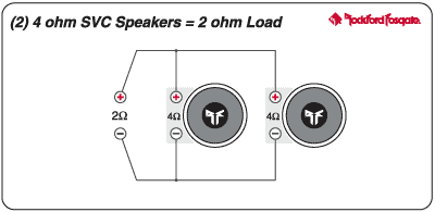

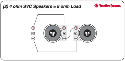

Would somebody mind elaborating on this a bit for me. I see the following diagrams that will make the amp "see" the subs @ 2Ohm and @ 8Ohm but not 4Ohm. As you can see I'm a novice at this and just trying to learn so any help would be greatly appreciated. Thanks a lot.

It's a two channel amp which means you will wire each sub to it's own channel. This will give you the 4 ohm load per channel and thus 200w each channel.
200w will be just fine for those subs. I own one and it can reach it's near max potential on 100 watts.
