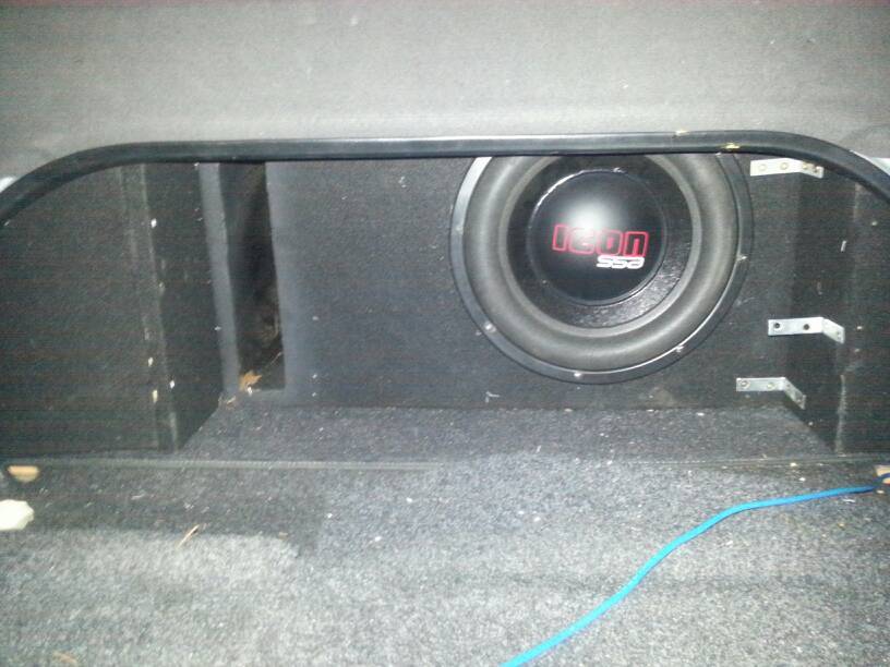

Question the ski pass is it small like an armrest or bigger like a seat? Yes it matters if a small opening facing forward and small opening = not going to work out easily.

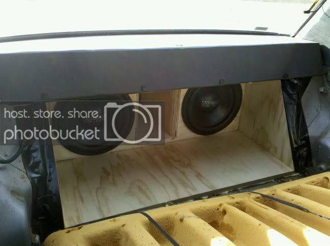

I 2nd facing subs forward but only if you completely seal the cabin from the trunk ( extremely important that you seal it 100% expanding foam x20 cans helps a lot) other wise face them as in the pics towards the rear. Oh ya 1 more important detail if you face them forward and seal the trunk the output from the subs will drop a fair amount when the ski pass is closed
Here this worked out great for me. Also notice the center of the rear dash that is actually a vent so when the seats are up I wouldn't lose any output And it worked quite well I almost couldn't tell a difference

Those pics explain much better haha. Definitely not something I'm looking to get into for my car... So, at it's current state the ski pass should be up and not folded down? And judging from he diagram my box should be close to the lid and not distant?

you dont have to remove anything or cut anything. Its about making what you have work. I faced my sub box forward and then cut out cardboard to fill in the holes that were there then i transferred cardboard to wood, carpeted it and called it good.

If you removed a nice size piece from the rear deck you could face subs up but ya cutting away at the car be careful good luck and post some pics when your done
