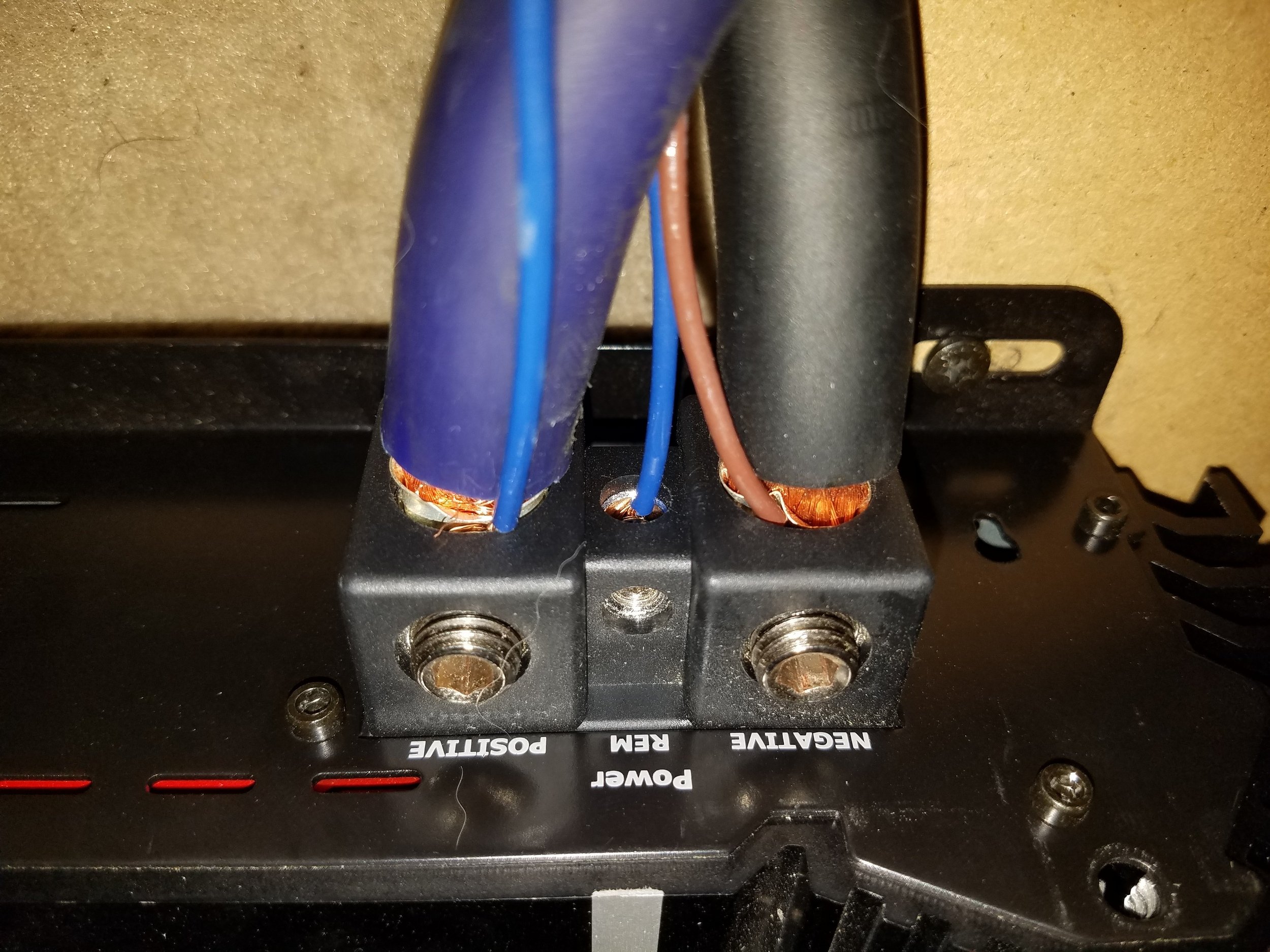

Remember this one from last year Jeff? LOL
And yeah don't wire them the way you are asking. You are just asking for trouble. As Jeff said too many things wrong with that suggestion.

Need more context on that picture. Here's a picture of mine. Using deck remote to pull in relay to control amp cooling fan. Not a complicated circuit, but looks as janky as the picture posted.
That was something some idiot did last year. He couldn't figure out why he wasn't getting and sound out of his subs and posted that. Gee I wonder why you have the speaker wires going into the power and ground wire.
