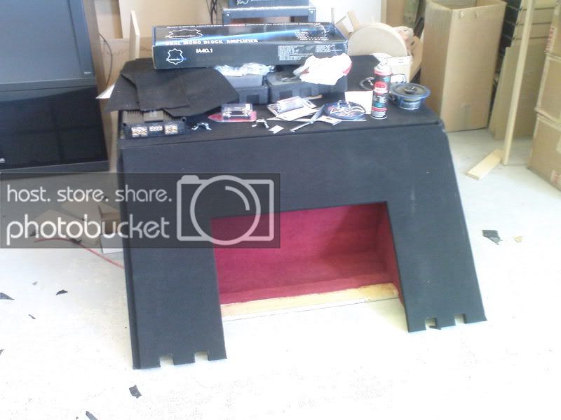

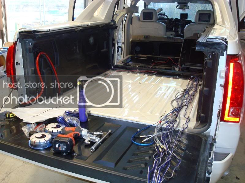

This is the Amps rak and battery box after we did the carpit!
And for anyone that does not know where this system is going to be in.......here is my baby!
LOL took me alot to get the plates!!
more pics soon!
lookin good. So you have anything in the lade yet or just working on getting it all assembled for now?
Working on mounting the amps ,and wiring right now. also working on the henges. Should be done with them soon. I am waiting for my last fues holder to get here so I can be done with everything befor I put it in!//content.invisioncic.com/y282845/emoticons/crazy.gif.c13912c32de98515d3142759a824dae7.gif

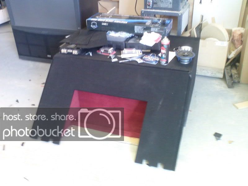

- All New box 16.1 cu" ported to 29hz.

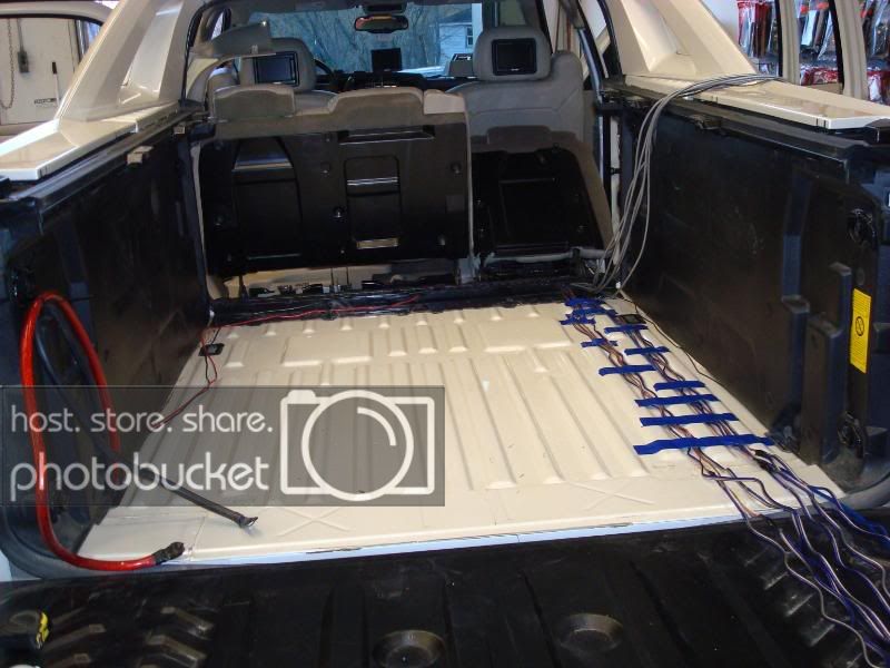

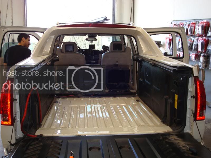

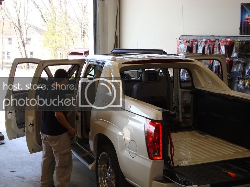

On Tuesday We took the old system out and started to make preparations for the new system.

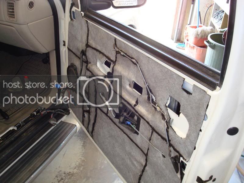

All the doors where Isolated with something batter then 2ndskin or dynamate. this is used to Isolate the engine noise on a Bugatti and RR.

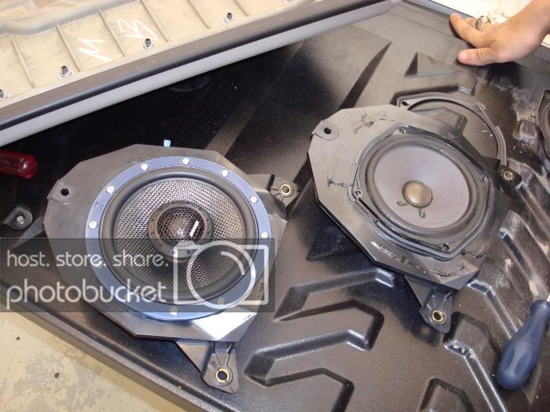

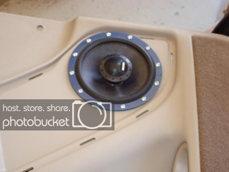

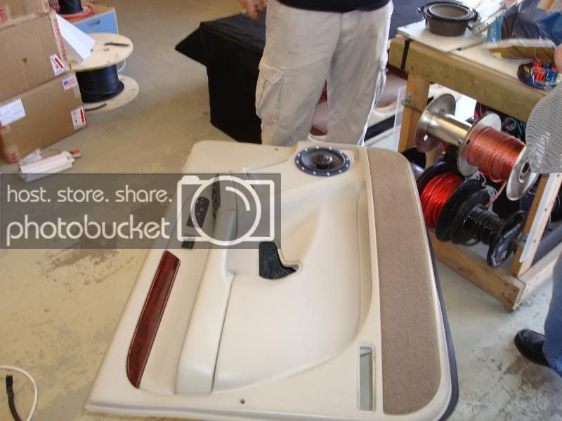

After everything was ready we started with installing the kicker SS65.2 comps. We used the old brackets for the rear speaks to mount the rear kickers in the doors ,and for the front we mounted them from the out side. (review) The SS65.2 are one of the best comps out there very clean very loud and will not distort on high volume. when it comes to high freq its really good the mid is also good but I am using them for high to keep up with the DP.

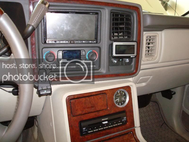

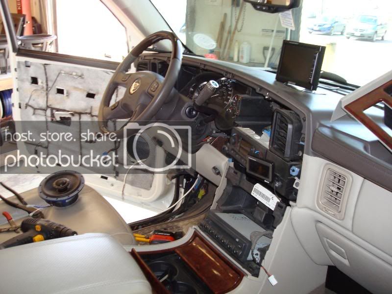

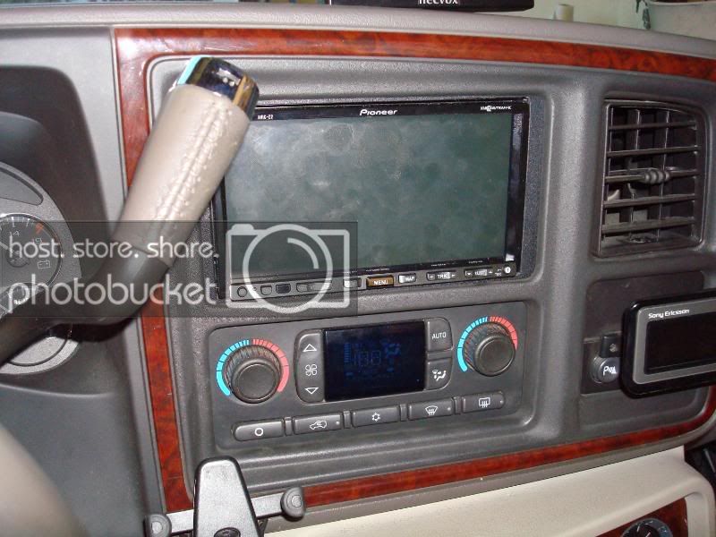

We then started to install the pioneers they where not easy to install because there was no space at the front...lol but we made space!(review) The pioneer Avic-z2 is the best unit I have ever owned it can do so much with the right accessories SQ is 10/10 really clear! options 10/10 allot of it 2. XM is really clear 2. Speed is 8/10 it can be faster if they have put in a HDD that is at least 7200 RPM but still really good. Navigation is 10/10 best thing I seen thus far.

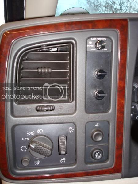

The Avic-z2 + the in dash DVD changer and my custom made control system are as followed:
There are 3 things here the IA 40.1 bass control , the IA 40.1 on/off Switch ,and the revers cam on switch this way i can have the cam on when driving to see the back.

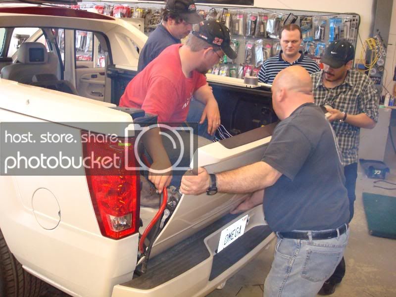

After that we started preparation for putting the new box in!

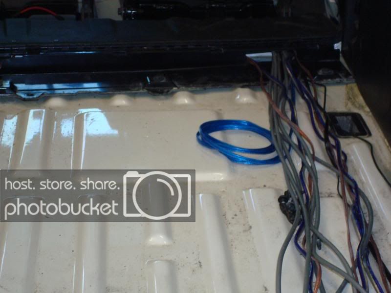

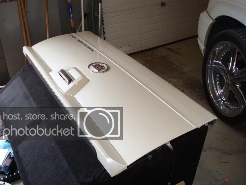

We had to take the gate off to put the system in.
