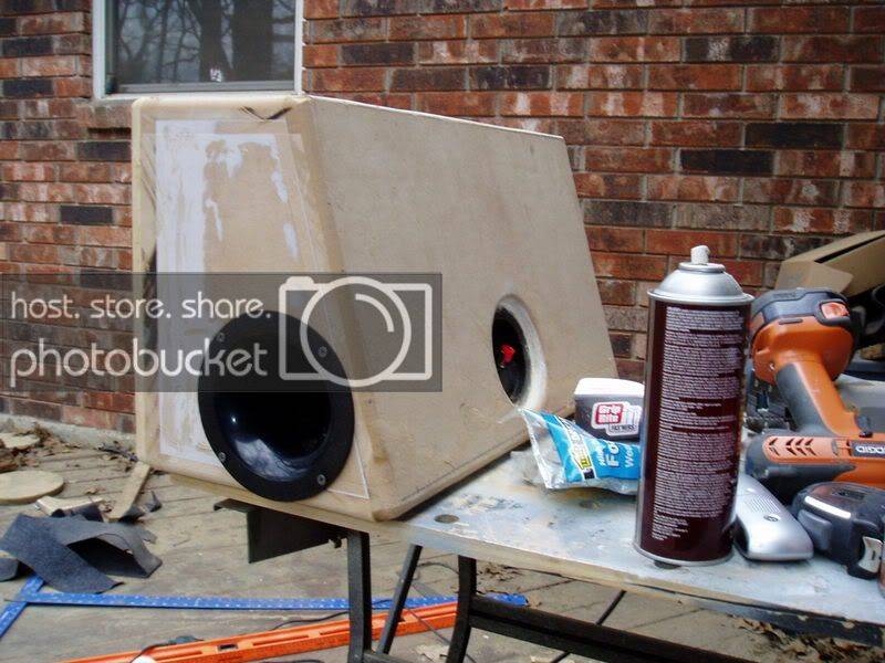

The box is 1 cube net tuned to 31hz with a 3 inch diameter aeroport. Sounds very good and gets nice and low. Will carpet some other time.
Why all the wood filler?
It used to be a bigger box and I cut it down smaller and had some gaps that I wanted to make sure were sealed up......It will most likely be going into a Maxima for a friend to add a little thump while kepping trunk space. You would never know it was an 8 inch sub with the output it has.

Ohh, if that's after a reduction, then that looks amazing. Excellent work. //content.invisioncic.com/y282845/emoticons/smile.gif.1ebc41e1811405b213edfc4622c41e27.gif
