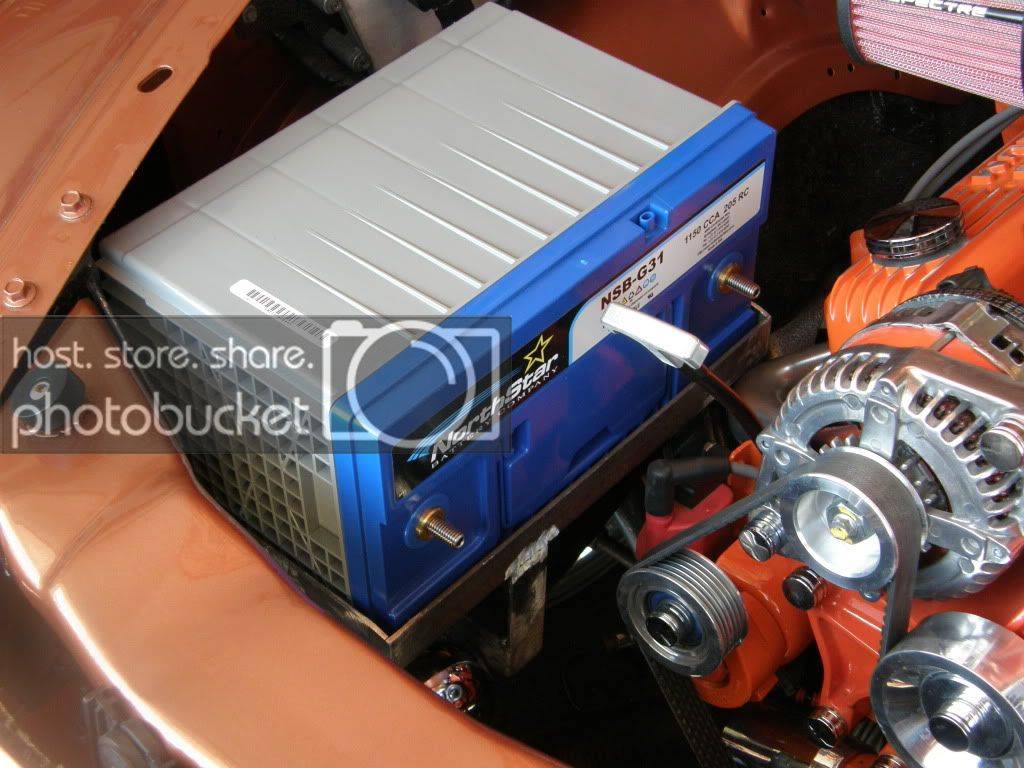

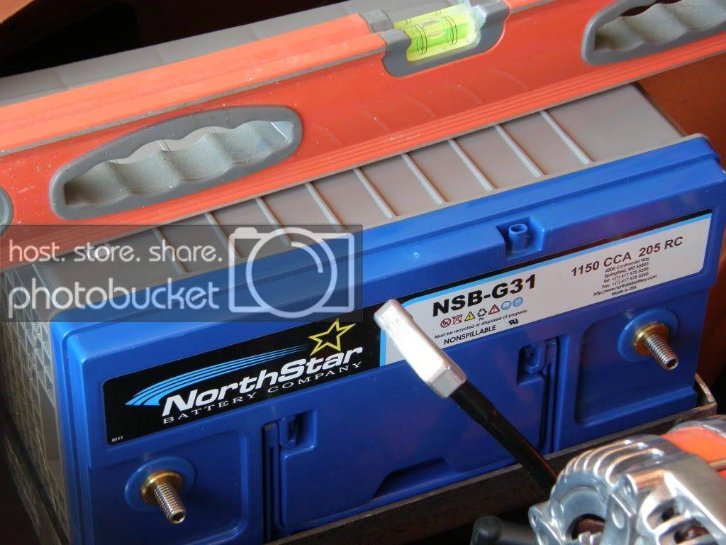

Well, I was lucky enough to pick up a sponsorship through NorthStar battery company. They seen my truck at SEMA with the Telcom batteries in the Bed and wanted to talk with me. They had no Idea I lived in their back yard. So after a few months here we are with Two of their new Blue Top G-31 AGM engine start batteries. Here are the specs for each of these batteries.
NSB G-31M
12 volts
1150 Cold Cranking Amps
1370 Marine Cranking Amps
2150 Pulse Cranking Amps
205 Minute Reserve Capacity
Electrical characteristics
BCI Group Number 31m
SAE Terminal configurations
Capacity - 20 Hour Rate 100Ah
Capacity - 10 Hour Rate 92Ah
Internal Resistance 2.2 m
Short Circuit Current 5000A
Measurements
Height w/Terminal 9.12 in
Width 6.77 in
Length w/Rib 12.91 in
Weight 77.8 lbs

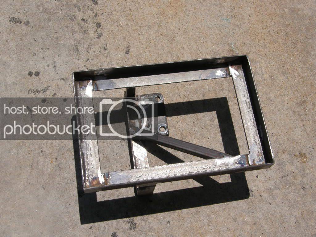

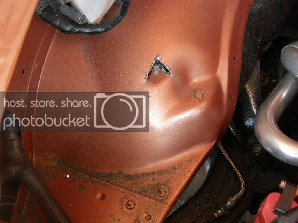

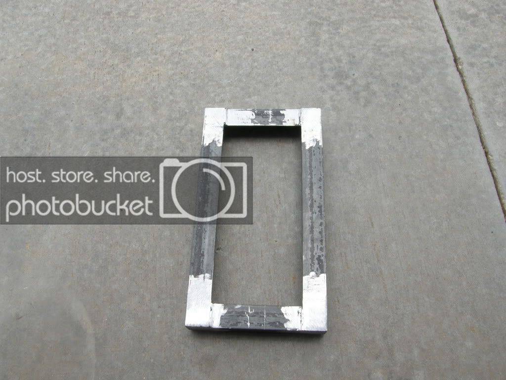

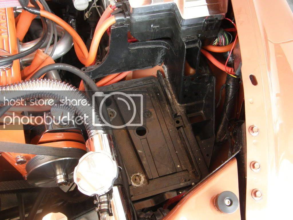

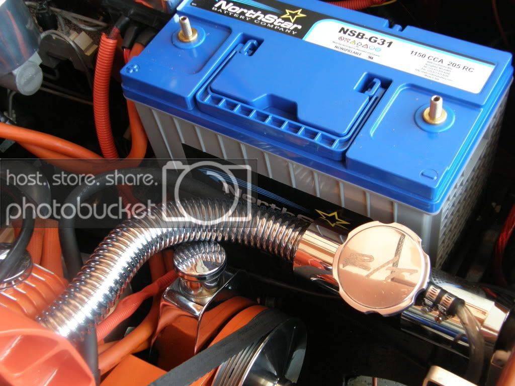

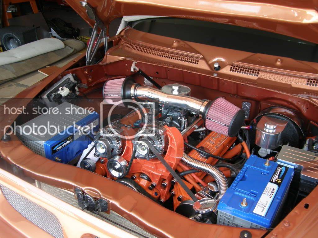

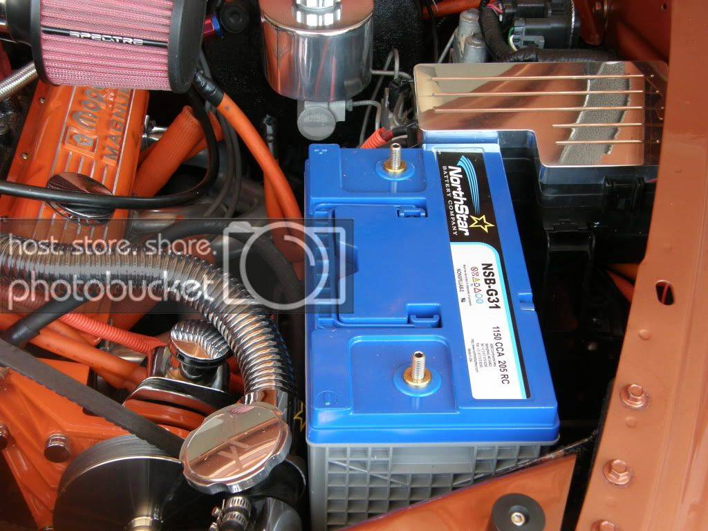

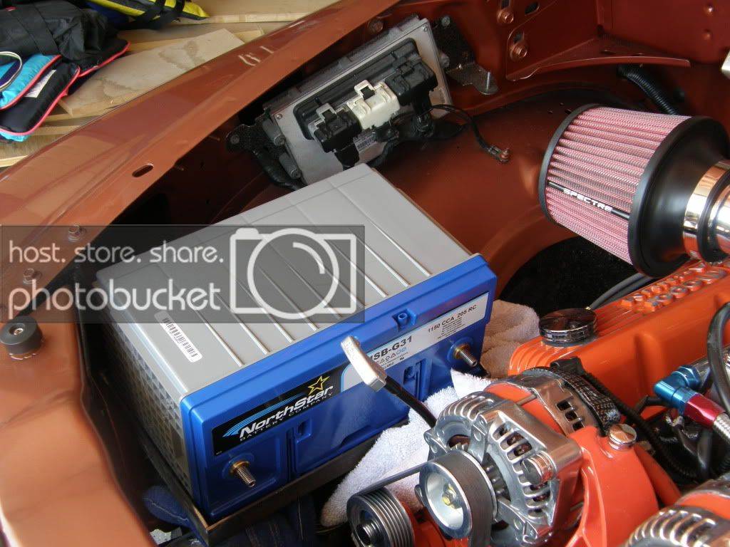

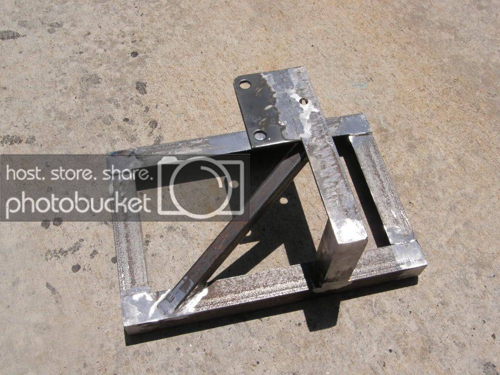

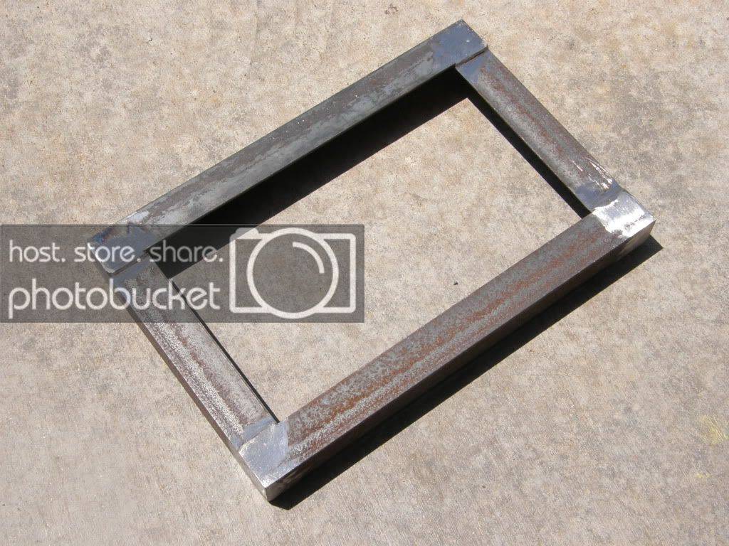

I started today cutting and welding. The idea behind their AGM design is that the battery can be mounted in almost any way except inverted. So I decided to use that to my advantage. I'll be building a battery rack in place of the stock battery tray and will mount one there as it usually is. I Decided to put the second battery on the passenger side and will be mounted on it's side. So far i only have the passenger side backet fabbed up but the driver side will come later this week.

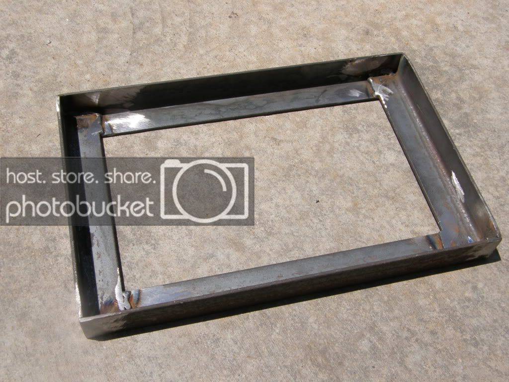

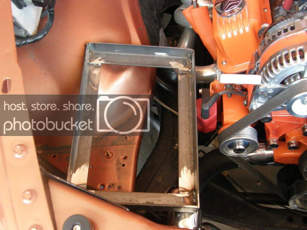

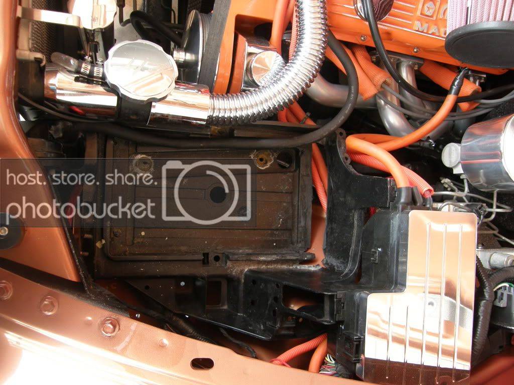

Started on the Driver side- I've been wanting to trash the stock battery tray for years and I now I can. Pulled it out and made the frame for the tray. I'll work on the supports tomorrow.

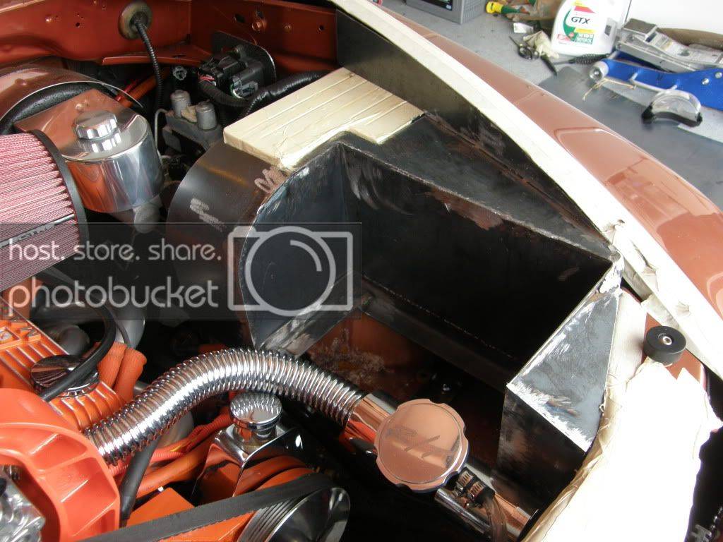

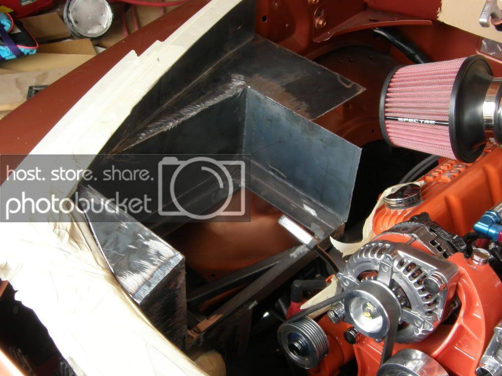

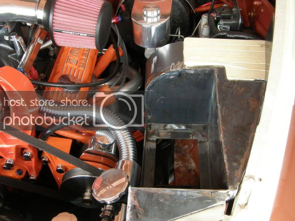

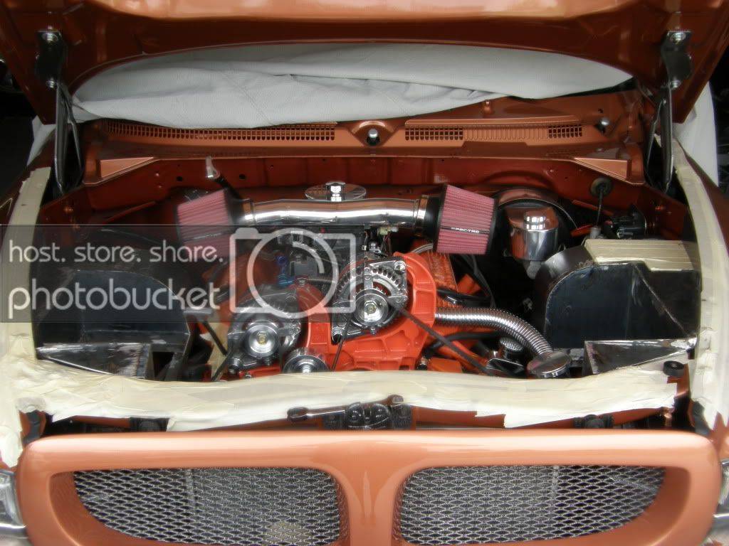

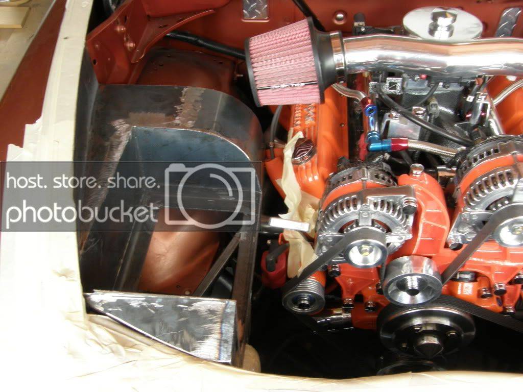

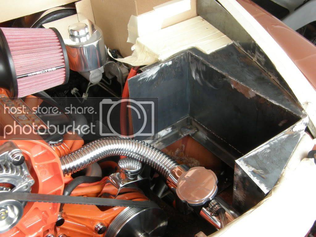

Been Busy but today I had some spare time to start the sheet metal around the battery boxes and engine bay. I am building these so they can easily be taken out if need be.

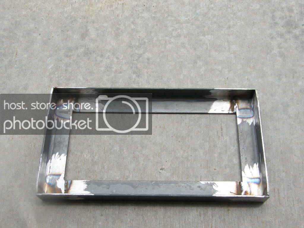

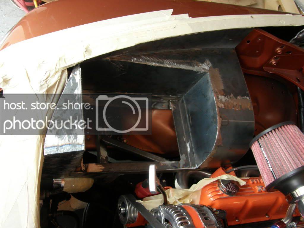

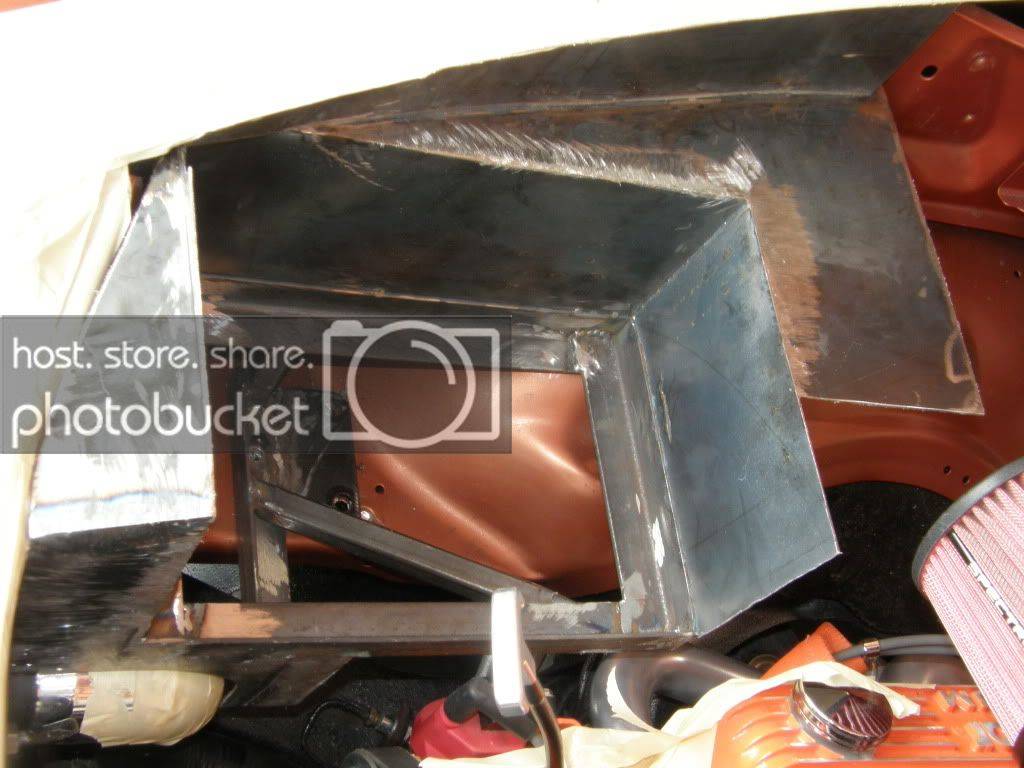

Put in a couple more hours of fab work today. Slowly comming along. Wish I had a Metal Brake -Would have made doing this alot easier, Instead I'm cutting out my panels using a plasma cutter, getting as close to my line as possible without burning through it and then grinding all my edges straight. This is what takes the most time. I'm also trying to keep both sides some what uniform so it's easier on the eye's.
