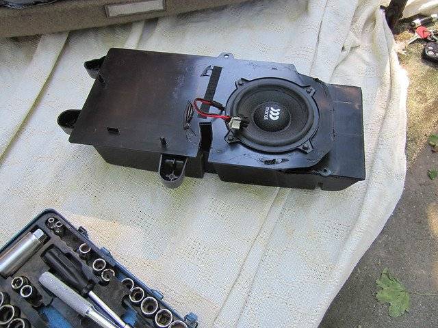

My choice for front stage was Morel Maximo 5.25" components. Mids mounted right into the factory location:

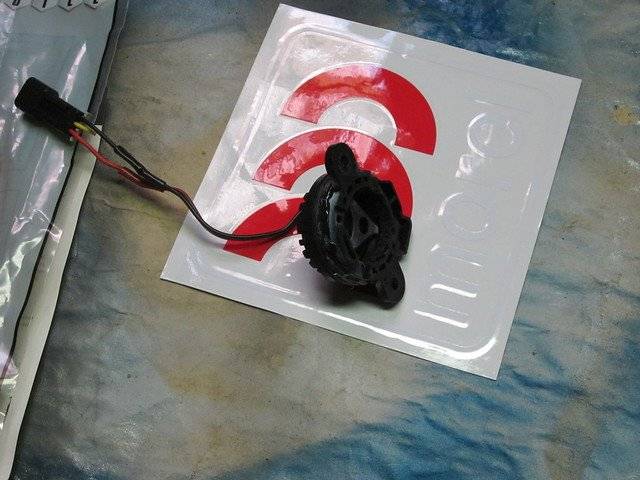

Tweeters are high in the doors, up near the dash. I had to fabricate mounting brackets and being pressed for time that day I chose to destroy the GM tweeters and steal the mounting flange. Glued them to the Morel tweets (I'm regretting that now) with superglue:

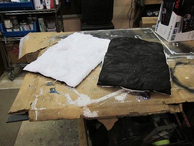

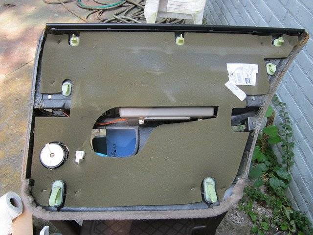

The Morel Maximos in stock locations on HU power were awful. Nasty midrange reflections that hurt my ears even at moderate volume. No midbass. WTF? Sounded worse than stock. Figured I'd get into the doors and do some deadening... here's what I found:
GM mounted the 5.25 mid to a sealed plastic box! Filled it with fiberfill (oooh, thanks)

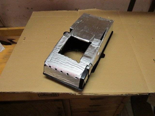

Now what? The Morels are obviously unhappy with this. I needed a long term solution, but for the short term I chopped a big hole in the back of the plastic enclosures and covered them with RAAMat:
Holes drilled for drainage. Also matted the door skins as much as possible.
Still sounded like crap, though better than before. At least the Morels aren't screaming at me. Need to deal with the on-axis tweets though, they're just too loud. I kept this configuration for a while and moved on to the amp rack and subs.

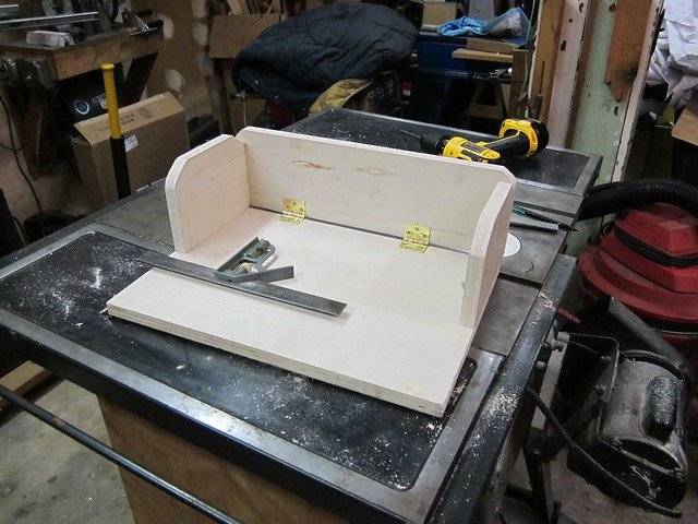

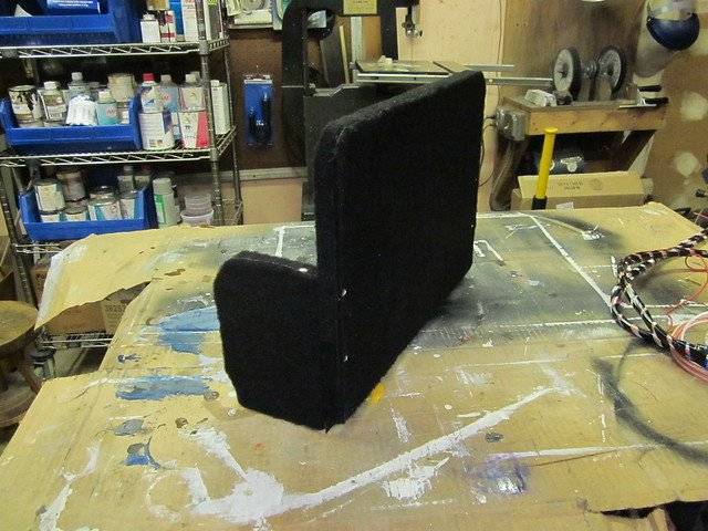

I have a spot in the trunk that I can fit a rack into without taking up much space. Bottom will be screwed to the floor, the front panel will drop on hinges for access. 3/4" plywood:
Painted and carpeted:

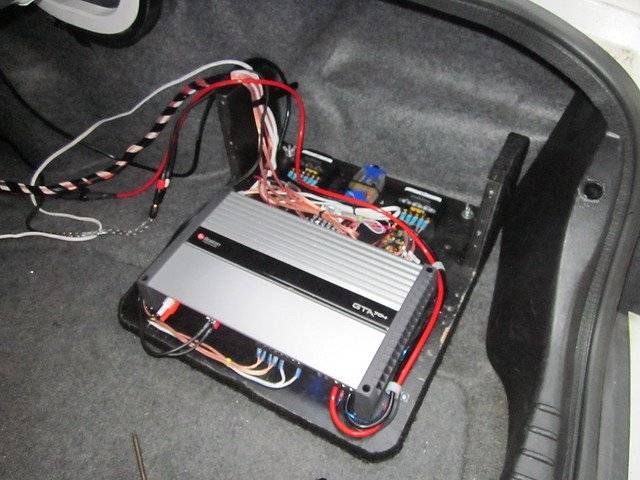

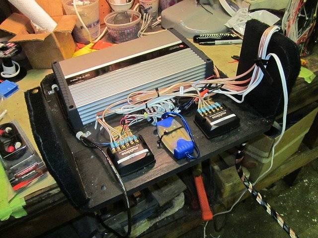

Parts mounted:

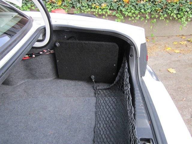

In place in the trunk:
It buttons up nicely. Notice that I even added the knobs for attaching the trunk net.

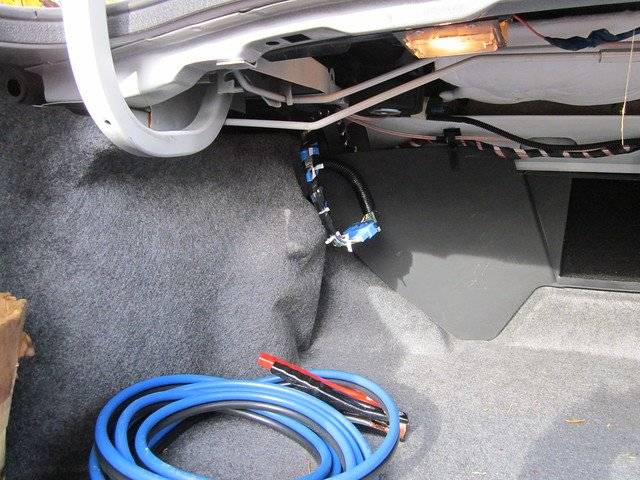

I had to run the power wire under the car. There's no way in hell to get a cable through the factory wiring channels inside. I'm running the front stage through a David Navone LOC which also has a remote output, so the only wire I had to run from the HU was the sub preout RCAs which I was able to hide under the carpet.

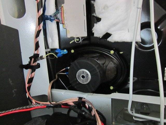

The CDT 6X9 subs fit OK under the rear deck, but I had to drill new holes. No idea why all 6X9s aren't the same mouting -
Like an idiot I neglected to RAAMat the plastic rear deck while I had it out of the car. The damm thing buzzes terribly. I think the 6X9s will go away in favor of a sealed sub box soon, but they suffice for now.

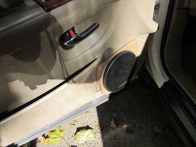

Plan B -
Wooden baffles covered with vinyl -

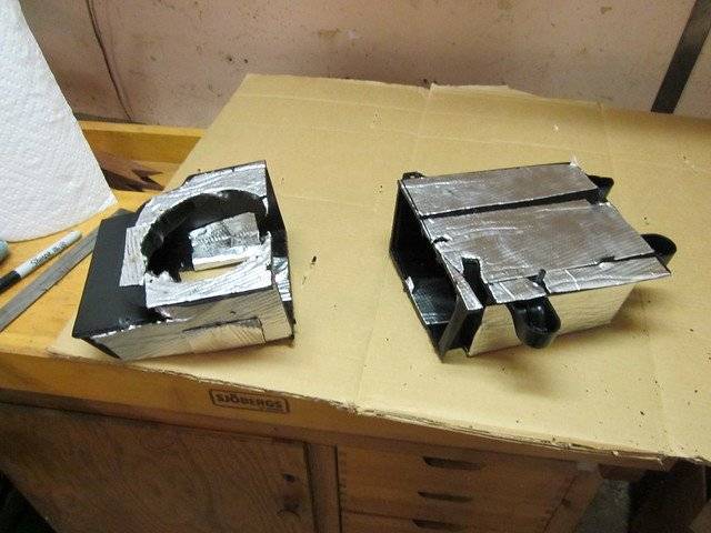

But the plastic box will be directly behind the speaker and still have an influence. The top of the boxes are also used for mounting window control electronics. Solution - band saw them in half:
The upper part is still used. I also threw some money at the install and went for HAT Imagine speakers so I don't have to deal with the Morel's tweeter on-axis. They have better midbass anyway:
