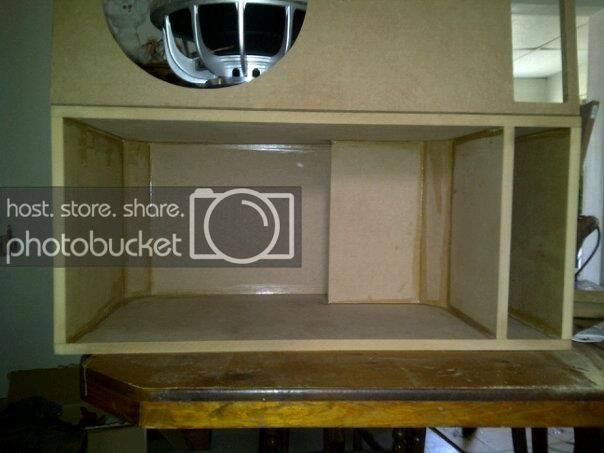

Almost there.
Front baffle is clamped now, and drying. 2nd baffle, paint, then done.
looks good man ask around and see if you know anyone with a router and a 1/4 round bit and go around all hard edges before you paint it.
Actually, I have a pretty nice router. Used it for my hole cuts in the baffles. Had to use it for the sub and port cut out, since my jigsaw took a crap on me. I have a decent circular, drill, and router.... just no proper work space, lol. Anyway, I like the sharp edges, and will be sanding them to perfection tomorrow. Then painting.

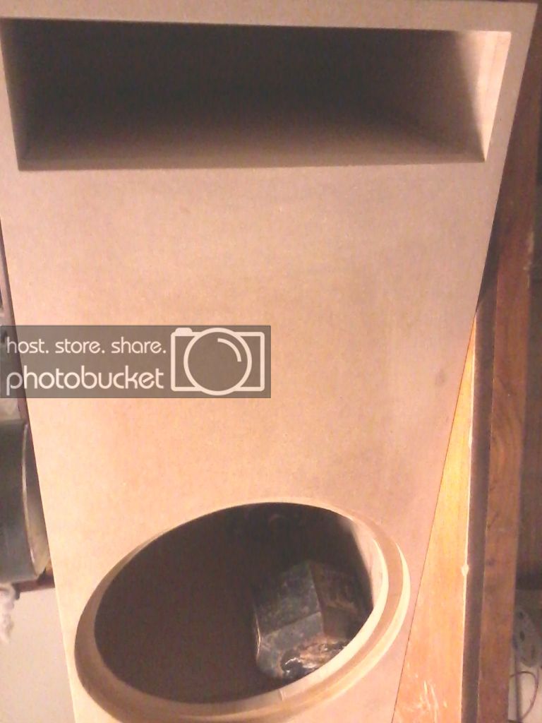

That's a good idea. What about corner covers, like on the outside of PA speakers? I honestly just don't feel like going out and buying the router bit just for that. Those things are fairly pricey for something I'll probably use once every 5 years, lol. I'll figure it out tomorrow before I paint it. The box is completely assembled, now. I just finished the 2nd baffle on the front. It's clamped and has about 150 lbs of metal weights on it. I'll post pics tomorrow after it dries. I still need to sand down the port holes that are cut into the baffles (so that they are flush with the port), but other than that, its looking decent.

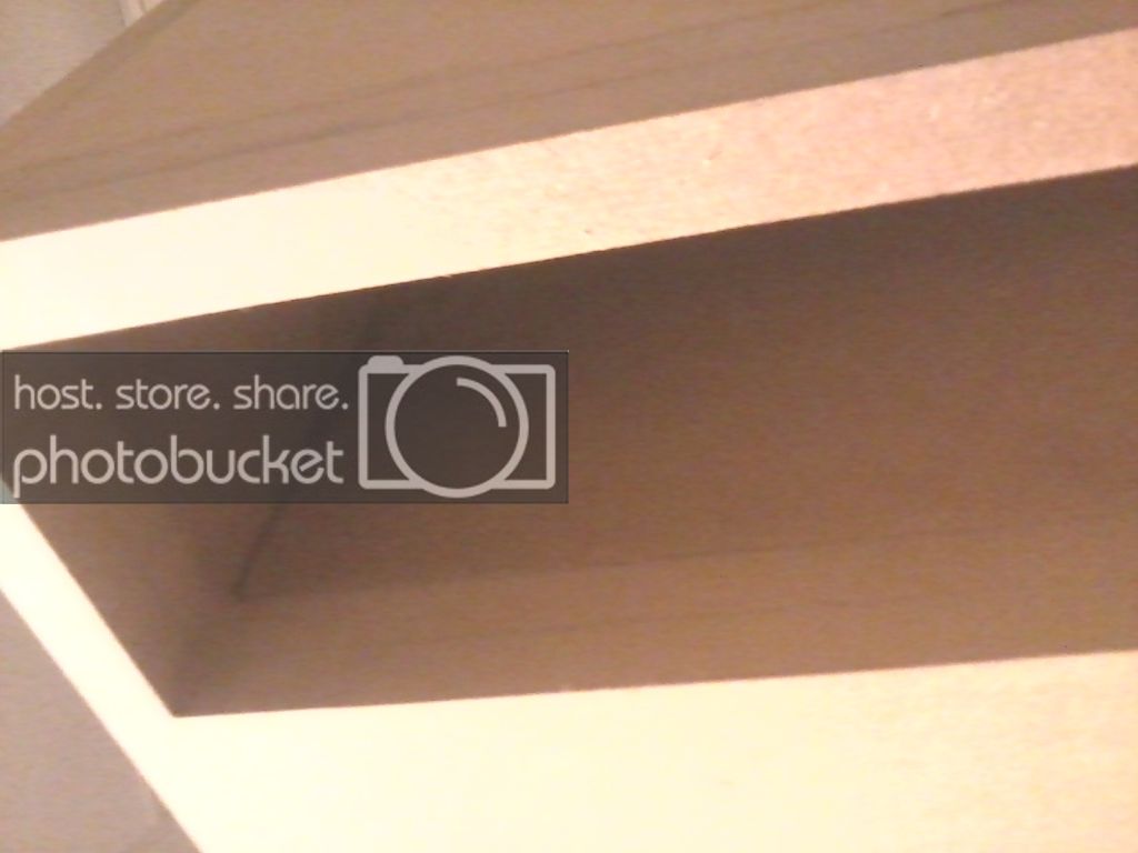

Rounding over sharp edges on box generally gains DEEBEEZ. Definitely worth doing around the opening of the port, and if your sub will flush mount you should round over around the outside of where the sub mounts.

Well, other than a lil router bites in the speaker holes, it's turned out decent. I'll spend tomorrow priming and painting. Not bad considering what I was working with. ...3 power tools, and a hand sanding block + about 30 sandpaper changes, and some clamps/dumbbells, lol. On a crappy old kitchen table. The weight + another one you can't see are holding down the last two 45's while the glue drys.
I'm especially loving how the port turned out. Can't make it any thing other than straight, so I made it as pretty as possible. I'll put a layer of primer, than gloss black, down it the best I can tomorrow. I meant to do that while it was still open, lol.
