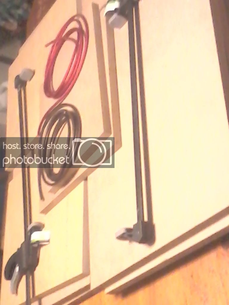

First joint.
We'll see how far I get tonight...

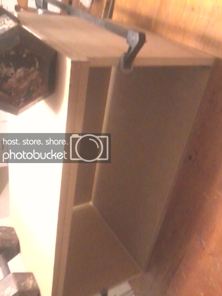

Here are the sides being clamped.

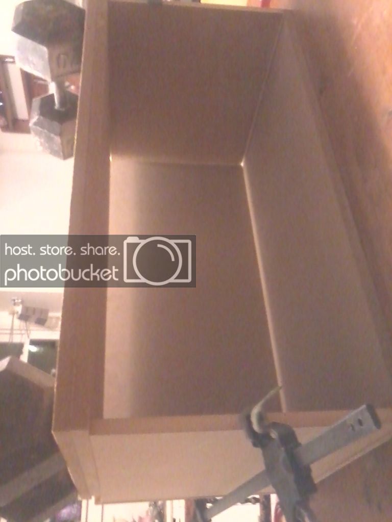

and another view...
I only have two clamps, so I went ahead put those going front/rear and placed 70 lb dumbells on top of a couple panels (what will be the top panel and one of the front baffles) to secure the sides to the bottom piece. This glue is fantastic, btw.. It says that you can remove clamps after 30 mins, but I went ahead and gave it 2 hours before removing them, after joining the rear panel and bottom. The joint was rock solid.

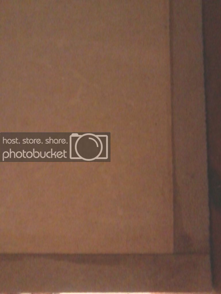

Here's a pic of the corner.

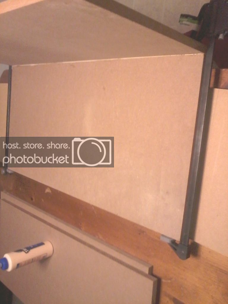

Cuts didn't turn out horrible for using my old sub box as a table to saw on, on the back porch. I just clamped a straight piece of wood to the panel i was cutting and positioned it as a guide for what ever cut I needed to make with my circular saw. Had to use a sanding block to smooth out a couple spots, but other than that, not shabby.
