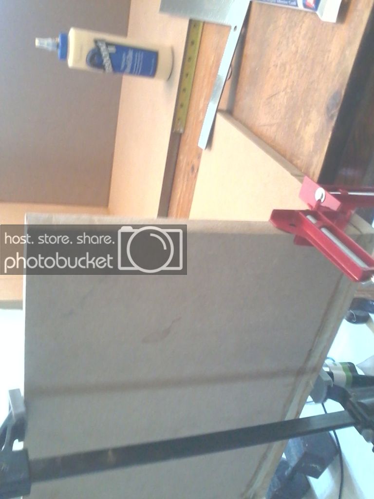

No screws?
This is all titebond II as well no screws what so ever.
I shit you not, your enclosure was the inspiration for my current build lol. I read about it a while back, and am picking up the bedliner tomorrow, lol.
Port walls clamped.

all I will say is there is a reason you see spl boxes with a screw every 1.5"
I would most certainly be using fasteners if this were for a higher powered system, but it's a single 15 that will never be hit with more than 1500 rms. Actually, I plan on tuning it to 1200. I know what my amp is, and don't want to push it. Plus, I don't compete. Or burp. Ever.
I would guess because they don't do a whole lot of wood working and are not aware of the fact that an adhesive bond is superior to a mechanical fastener in every way!
no it would be the fact that a mechanical fastener acts as a stiffener, while the actual bond may be chemical and superior it does not extend past the surface as a screw will. Going for tenths on the meter the screws will give them the extra hundredth they may need.

I bet everyone of those boxes would continue to pound if you pulled all there screws as well, a while back I made a box for a single T2 ten for a guy he didn't want to wait for me to glue it so he said just use screws and I'll glue it later needless to say it lasted minutes before the box was flapping and pulling out screws on just a test run! but it's what he wanted.
But on a note screws every 1.5" if applied before the glue had dried would make for a much better bond if you where building a massive box and didn't own a sh*t ton of clamps.
they would still work, but they might also lose that .001db that the screws give. I am not suggesting that they need to be used or that glue isn't. I am just saying they do add strength even if at just a miniscule level. My boxes usually have screws just because I'm to impatient to clamp. I'll probably start nailing one of these days.
