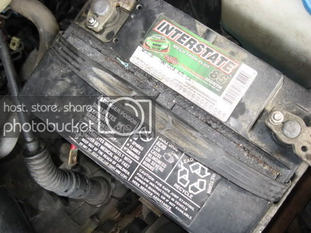

Here is my existing battery to power my car.

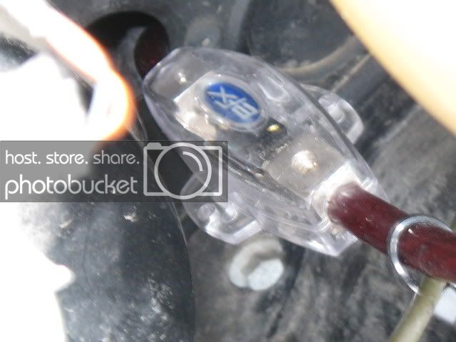

Then runs into my first Mini wafer ANL 125A fuse

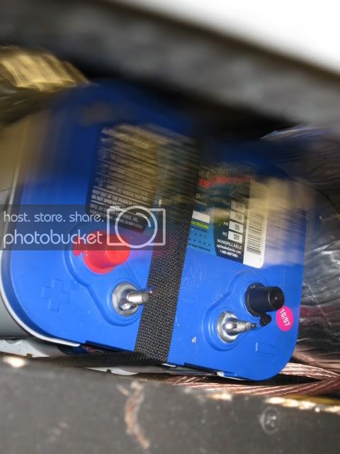

4guage power wire runs into the Blue top from the Interstate battery

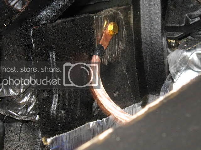

Properly grounded

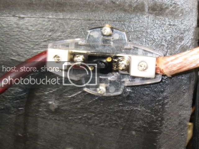

Then from the postitive (+) runs into another 125A fuse then from there into the Amplifier

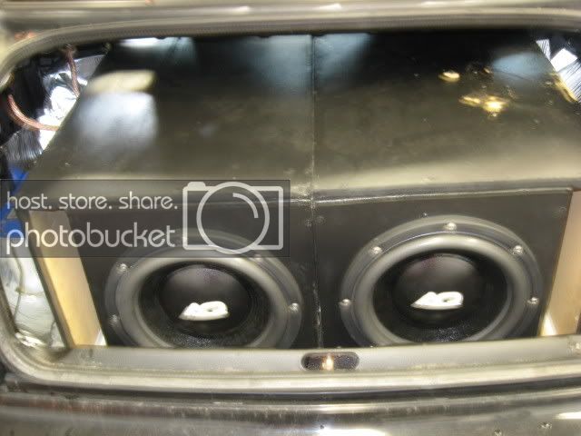

Then hopefully power these

wiring second battery in series is a big no no. That means you are running 24 volts. Wire it in a parallel so that it will be 12 volts again. That is probly the reason it fried your amp.
So I guess thats how I have it now? My positive power wire going to the Positive of the blue top, then both negatives being grounded to the chasis. Wonder what made me think that is series? How would series be ran then?

I would like run 2ohms instead of trying to push the subs that hard at 1 ohm.. How do you keep 2ohms instead of 1ohm when running the speaker wires into the amp wired in parallel?
I would get the soundstream amp, which may be more efficient. And run your pos from one bat to the other. And you got two choices for the ground. Either run it to the ground in the trunk or to the ground on the other bat.
Series would be positive of the interstate going to the negative of the blue top, positive from blue top going to alt, starter, etc and negative from the interstate being grounded to chassis. You don't want to do that tho lol

And as far as the grounding, I do have the blue top grounded in the trunk. So Im good with the battery set up correct?
