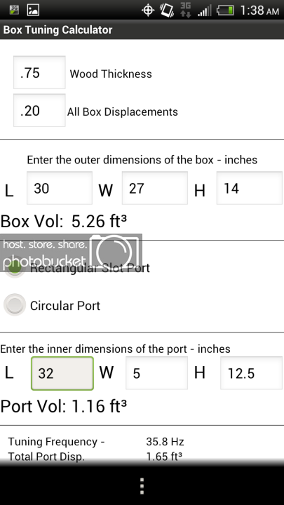

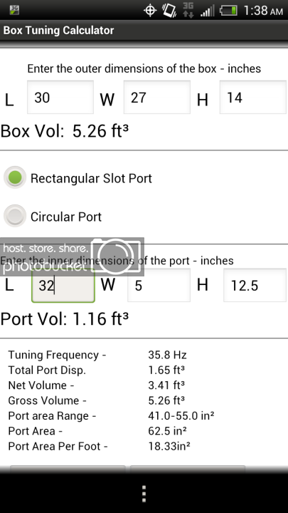

Well not sure if it'll help but here. Just one that I made for my car. The displacement is the displacement of the subs. It'll tell you on the specs, you wanna go for like 18 sq inches of port per cube. Tune anywhere from 28hz of you really like those lows, all the way up to like 38. Not sure if it'll help but sometimes pics Mir a diff.
