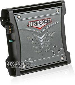

kicker zx200.2 200 watts rms at 4 ohm's(blew)http://www.sonicelectronix.com/item_11542_Kicker+08ZX200.2.html

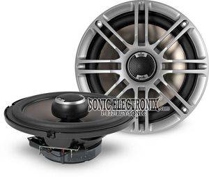

http://www.sonicelectronix.com/item_12260_JBL+P660C.html
http://www.sonicelectronix.com/item_12266_JBL+P662.html

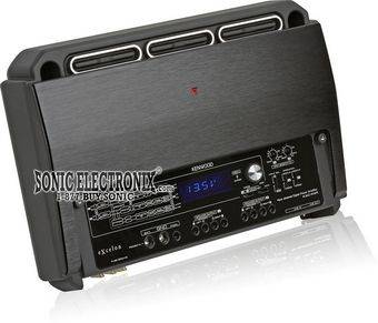

http://www.sonicelectronix.com/item_12053_Kenwood+eXcelon+KAC-X4R.html
I really like the 4 channel kenwood amp, looks really flashy lol, good access to controls and i guess it comes with some extra bells and whisles. puts out 150rms at 2ohm's
I was gonna get the infinity kappa's but when i listened to em they sounded to tingy to me, really bright highs, I would think jbl would have some better mid range that wouldn't be so easily overpowered by the highs. anyone got any other thoughts on that and the other parts I've selected? also probably gonna build my own box.

I wouldn't waste money on rear speakers. Kenwood amps dont have a very good reputation, but the kenwood excelon series do. So i would find a new mono amp and stick with that x4r.

I'm not sure about leavng 2ohm's thought, i like the fact that i'll hav 150 watts at each speaker, otherwise I'll end up getting only 25 more watts per speakers than what ive been getitng, granted im sure it's more like only 50-60 rms in true rms, I doubt its rated at what it puts out, it wasn't that expensive of an amp.

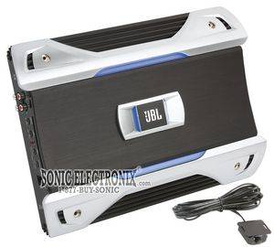

was looking at some other amps id consider, im liking the looks of this jbl mono amp.
http://www.sonicelectronix.com/item_12248_JBL+GTO7001.html

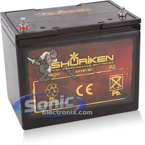

I was looking into the new battery could i just mount it in the trunk right where the split is in front of the amp's in the circuit, maybe a smaller battery, like
http://www.sonicelectronix.com/item_17904_SHURiKEN+SK-BT80.html
could I run this battery alone to be able to power this? or could i run it in parallel with my existing battery? if i ran them in parallel I'd have to put an isolator in between them so that it wouldn't drain the power form the good battery into the old shitty battery? I'd like to avoid 2 battery's, so if that one alone with maybe a new more powerful alternator :-\

so I think that batteyr i chose should be good enough with a new alternator after looking at it's spec's it should be able to keep up with those amps easily as long as the alternator keeps up.
I don't think im gonna run it with my current battery that'll just be unneeded.
