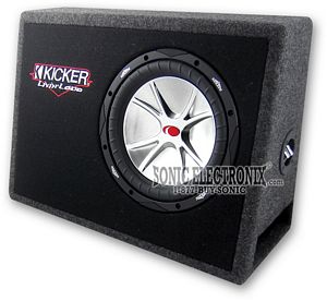

(2) 12" Kicker cvr dual 2 ohm
(2) 10" Kicker cvr dual 2 ohm
amp
(1) Hifonics BXi 2006D
and im going to wire them to a 1 ohm load and with all four subs it should need like 1400w rms and the hifonics does like 2000w at 1 ohm and i heard they were overrated a bit so i think that should be good and probably like a 2 farad cap does that sound good? all going into a 2001 chevy silverado reg cab
well i was thinking the 10's would hit in the higher tones (tiny bit but still somehting) that the 12's wouldnt be able to hit so my best bet is to just get 4 12's but i dont think i have enough air space box - TD 6"x BD 9"X W 55", H 15" does that sound like enough air space for 4 12's and also what amp to run with 4 12's and if that box doesnt have enough airspace would 4 10's be more suitable?
ok well im realli for more spl then anything would 4 10 but louder than 2 12's?//content.invisioncic.com/y282845/emoticons/yumyum.gif.0556df42231b304b9c995aefd13928a8.gif
