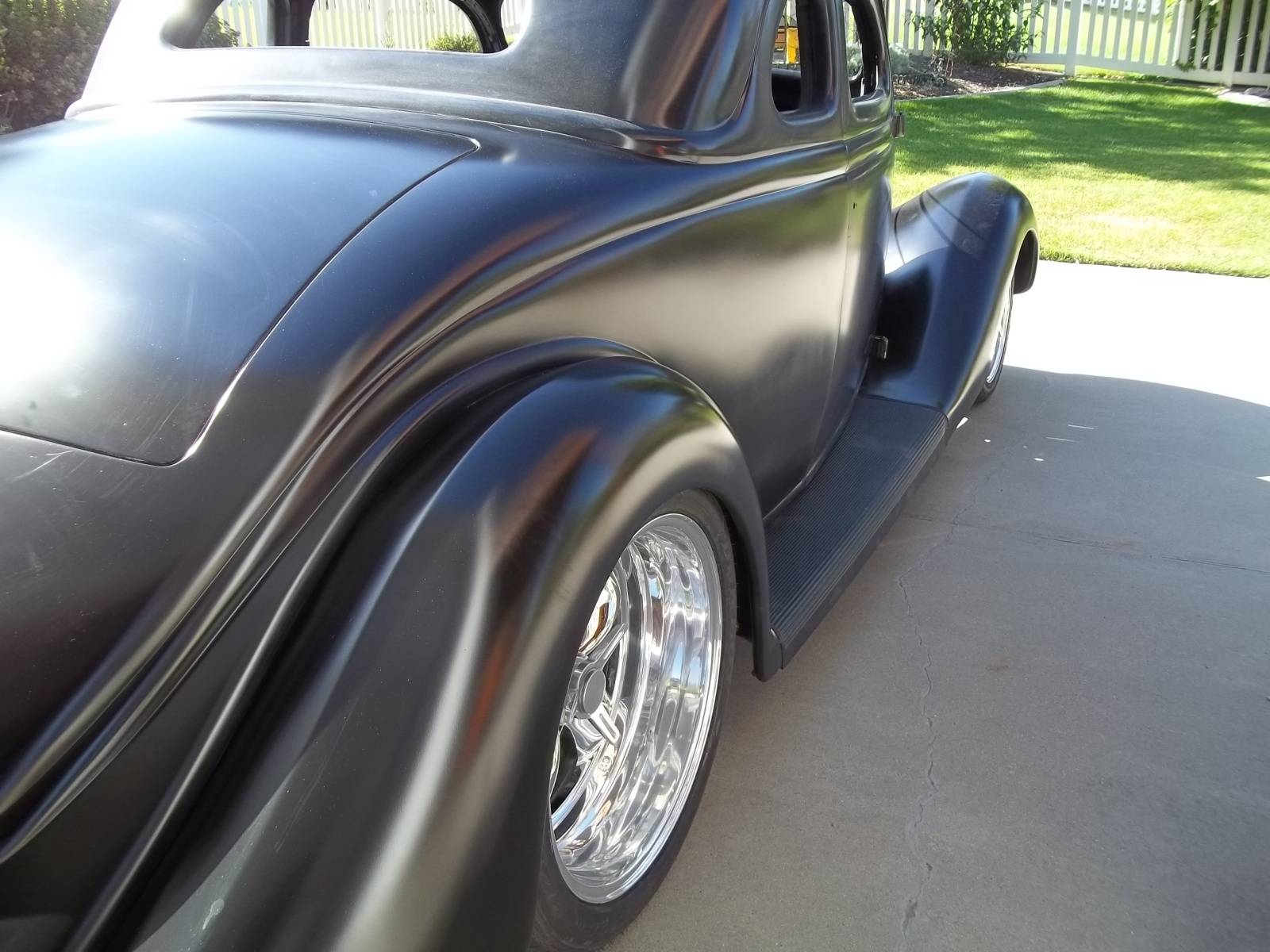

Anyway, here are a few Pictures:

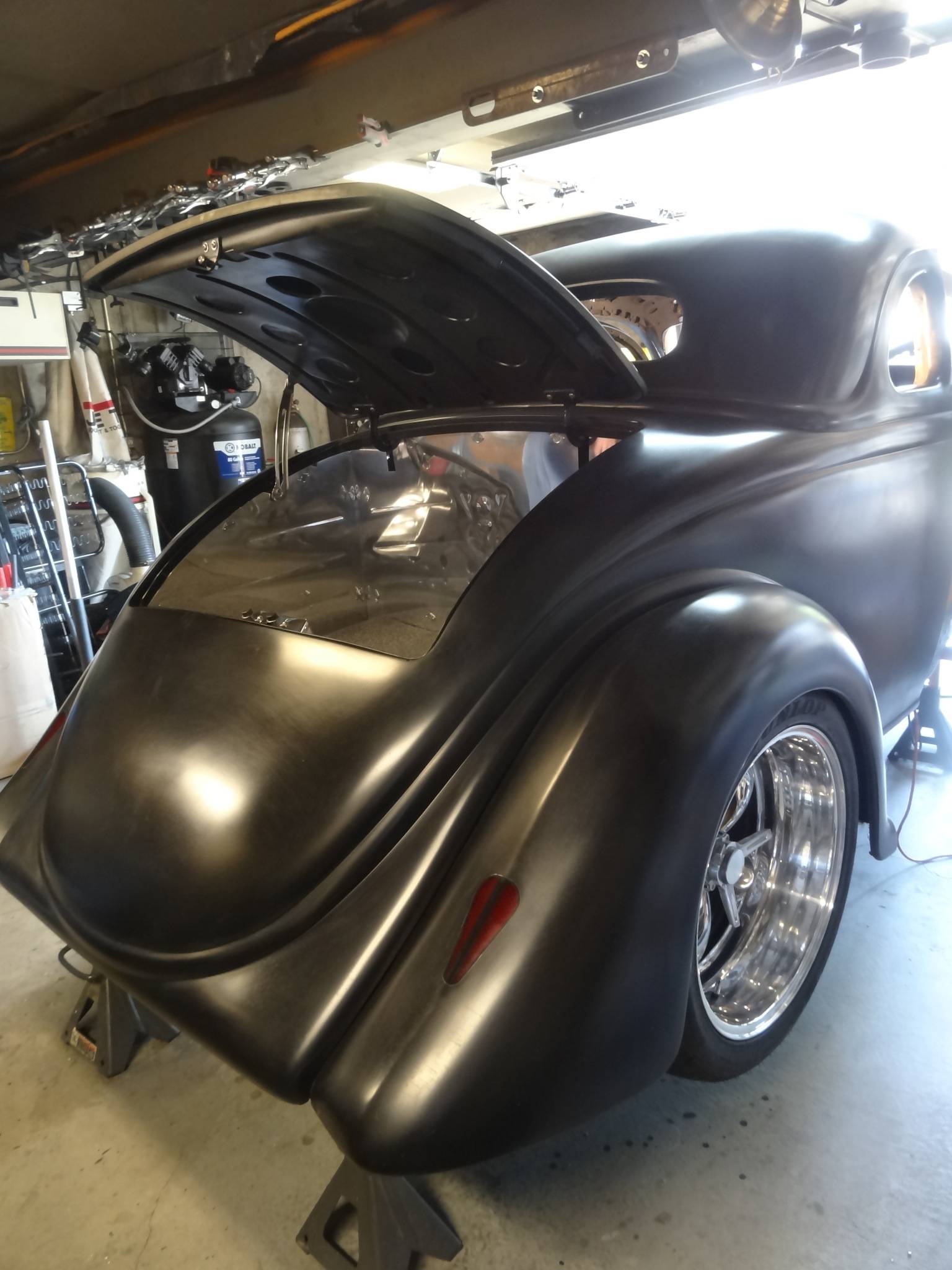

Here is the Car (it will be Painted Gloss Black):

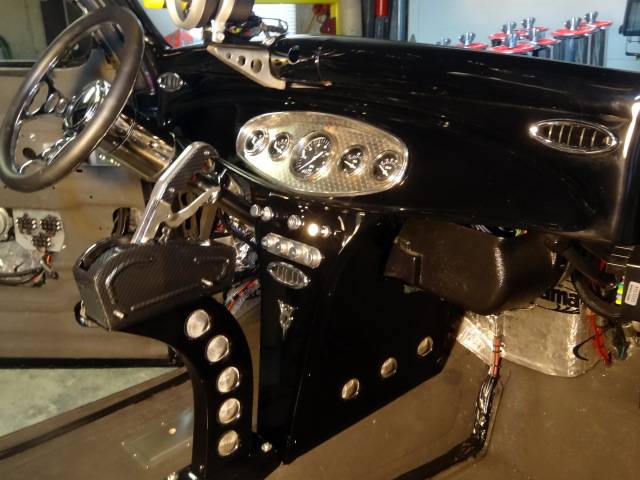

This is where the Interior is today:

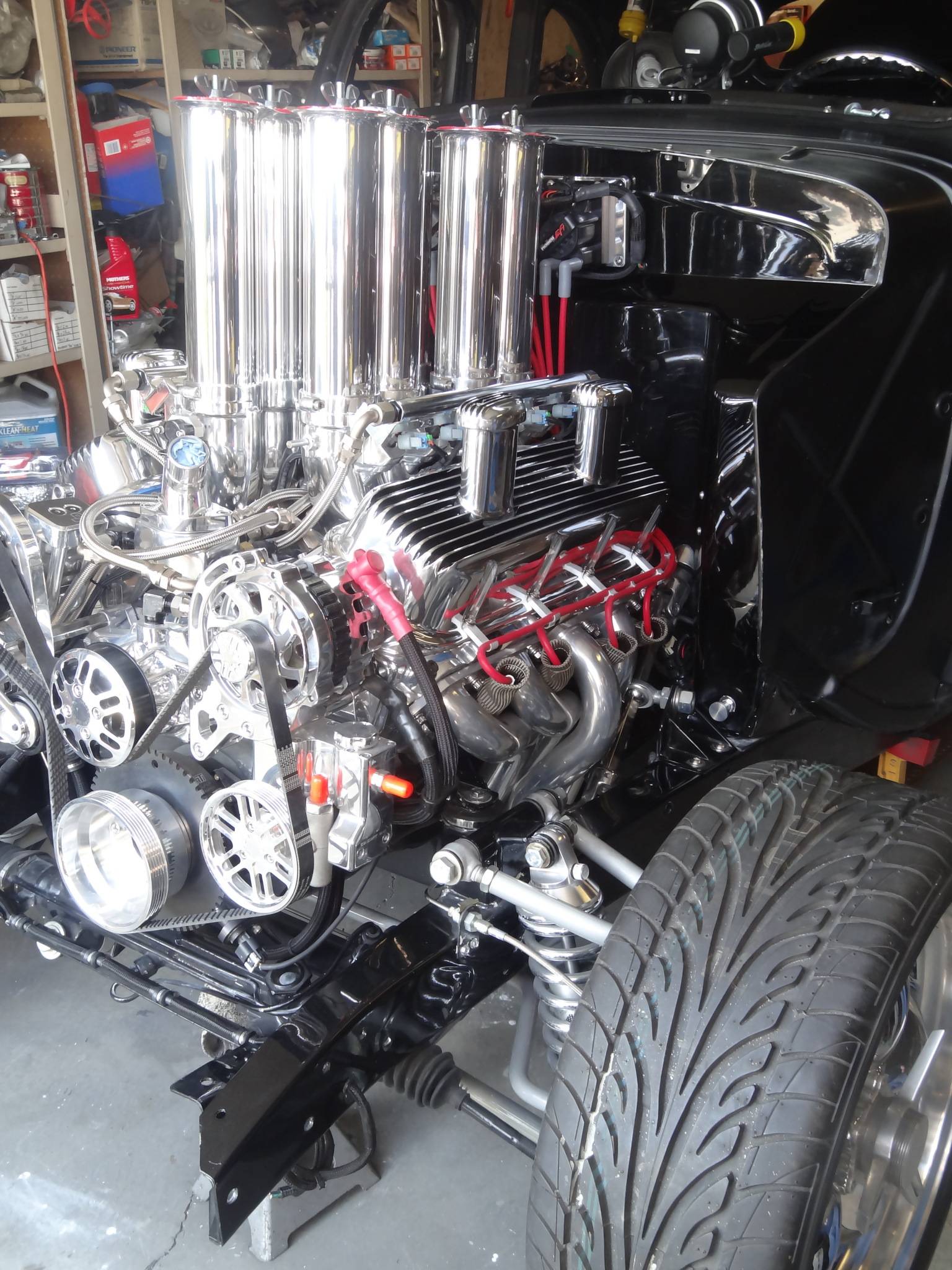

Here is the Engine:

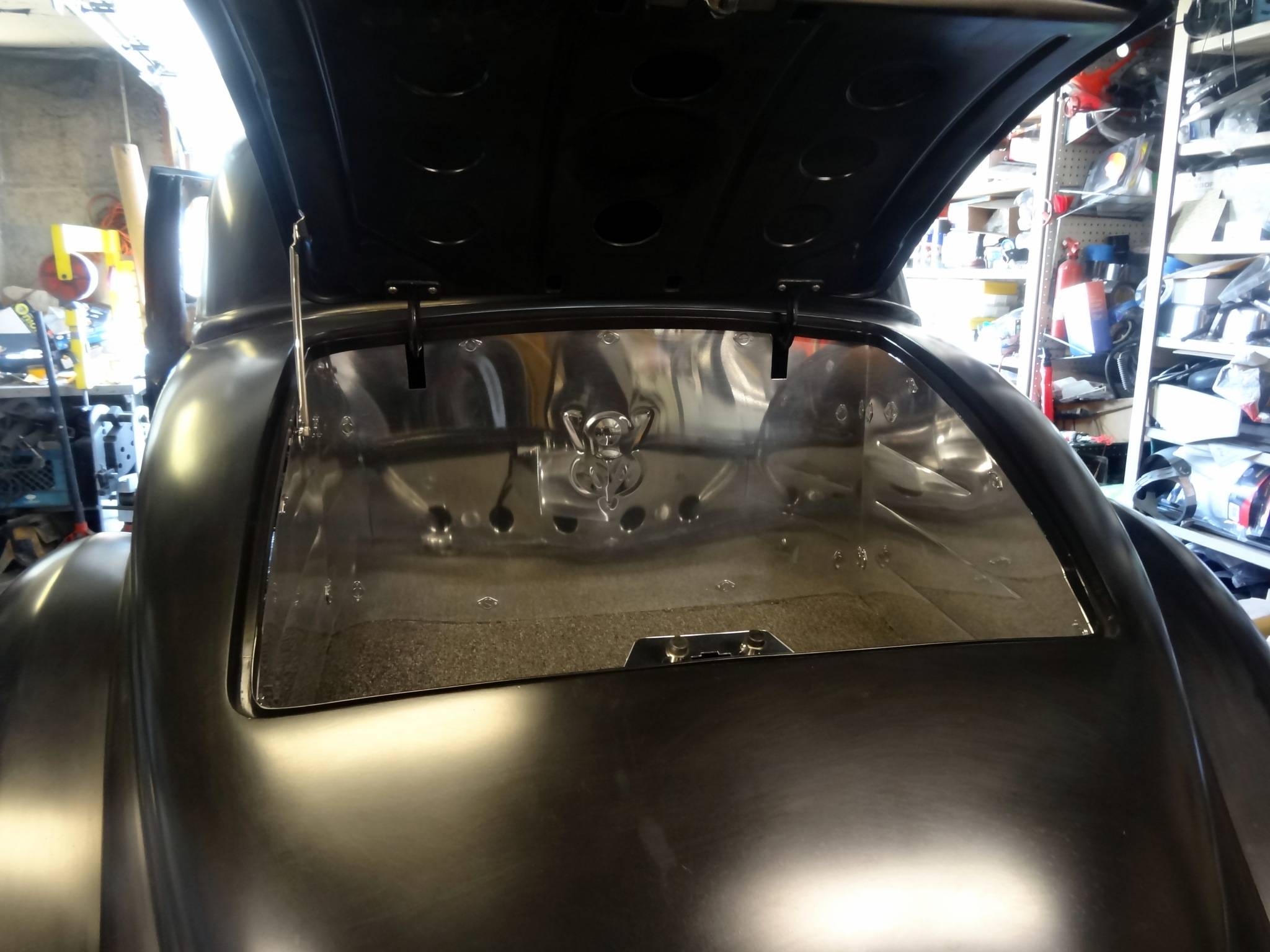

Here is the Trunk so far:
Here is the Engine:
Holy crap, what a nice monster you got there...really B@d@ss looking ! The ITB setup looks just insane ! That thing must roar like a mothafucka !
Dear God that's an engine! What a nice old car.
Much less trunk space than I expected. How much metal/meat is between the trunk and the passenger compartment? It might be tough getting any bass up front whatsoever, particularly if you have limited space. The saying goes "space makes bass". Your main limit eventually becomes how big of a box you can use.
Is there any place on or under the dash you could just hide a head unit behind a panel that can be removed (manually or opened by servo) so that you can have easy access when you need but keep it "stealth" too? I've seen a lot of folks with classic cars mount them in the glove box for example.

I have actually cut up the Dash, and took out the Glovebox as I wanted as "clean" of an Instrument Panel as I could make it (that is actually a 1932 Ford Roadster Dash)-
I really don't have much space under the Dash (as I have my Holley EFI Computer and Air Conditioner/Heater there)-it may be a possibility to run a "Bass Tube" kinda deal behind the Seat maybe (but I don't know much about them)-

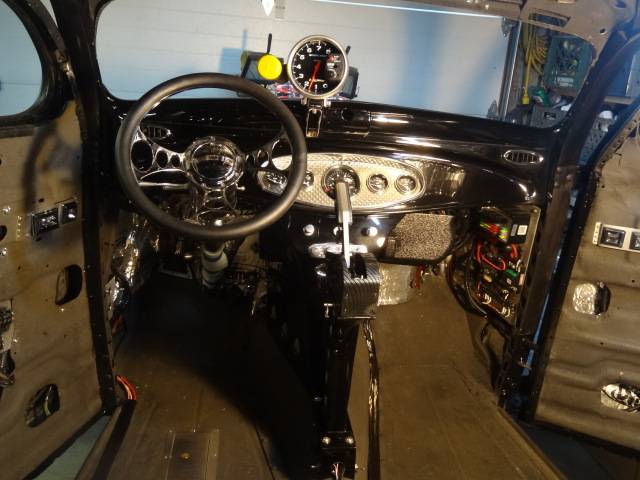

Here is an earlier picture of my Interior (just after I sprayed Lizard Skin and started installing the Dynamat)-see the black bracing? See the left rear Wheel Tub? I actually have that space above the Wheel Tub that I could build some kind of a Box to house a Sub (maybe one on each side? Kindahard to see, but the brace curves-)-
As for a Head Unit, I think if I have to have it, I would like to mount it in the Back and control it with a Remote (if possible)-you can also see the Trunk space (that I built-these Cars originally did not have a Trunk)-
That indent in the floor could be reinforced with fiberglass, faced off with some MDF, and hold a 10" sub or two. Alternate option you could seal off that "trunk" from the cabin really well and mount a sub to that "free air" or "infinite baffle" we call it. Essentially using your trunk as a box, so you chose a sub that performs well in a very large sealed box. This is a great method for being relatively easy and space saving. Also if you got something with a pretty backside it would show nicely when you pop the trunk. Use the search function on the site for "infinite baffle" and see some examples. Either would give plenty of low end for sane folks.
Infinite baffle would be my advice unless you're somewhat comfortable with fiberglass. Looks like you could seal that off with a relatively square piece of wood, cut a hole or two, paint/carpet and call it a day while giving up virtually no space.
Pics of the dash area?
Here is the best I have right now (the Holley EFI Computer is mounted above the Steering Column, and you can see the Air Conditioner under the right side of the Dash (it's the textured piece):

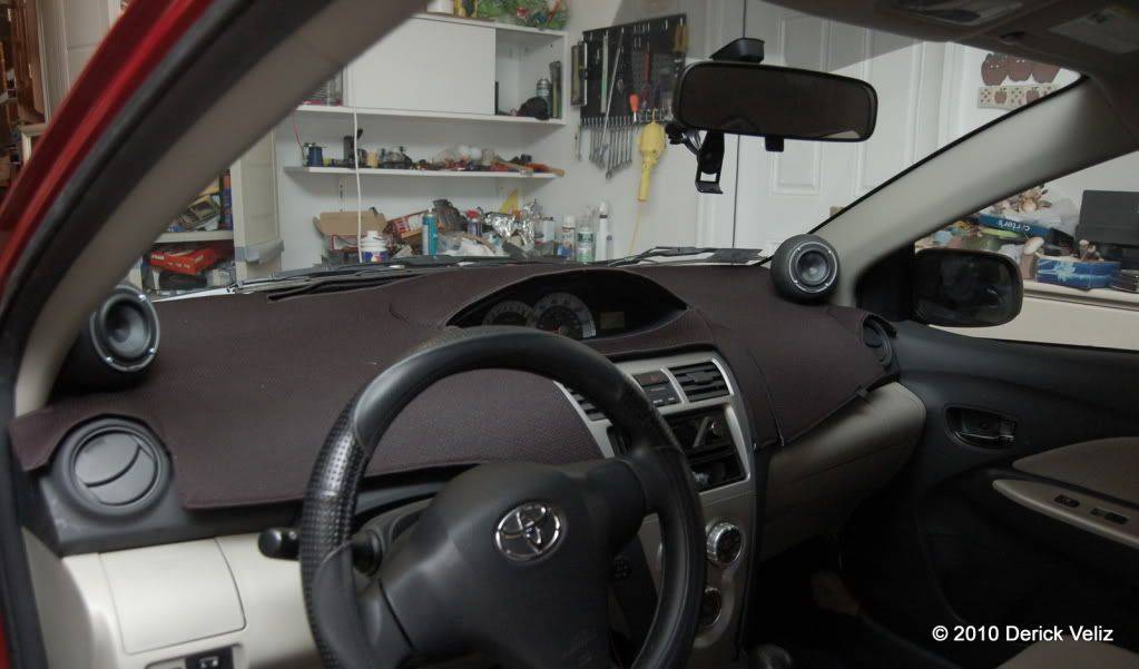

All kidding aside, yeah that's not much of a "dash" to work with at all, though you might get away with something like this for mounting component speakers (if you don't mind some itch itch).
his full install is here: 2008 Yaris Sedan Deadening and Sound System - Car Audio | DiyMobileAudio.com | Car Stereo Forum
Not terribly loud but sounds absolutely amazing. I mention it because the floating eye look mounting small woofers and tweeters on the dash would match your custom display and the imaging is pretty top notch keeping the soundstage up high like that. Also consider just tweeters up high and mids in the doors or kicks.

For subwoofers which direction they face will be inaudible and only a cosmetic choice. Do go ahead and google "infinite baffle trunk" and see some images. There's some good examples there. I've heard a few and they sound really nice if you pick drivers that work well for that application.

The important bit with doing IB correctly is completely sealing off the trunk airtight and use a stout baffle (double layer 3/4"). From there, pick woofer(s) with low FS (20-30hz neighborhood) and Qts between .6 and 1.0 (.707 is considered optimum but you'll have some wiggle room there). Some companies geared towards home theater make some nice IB oriented woofers. In a home you'd do them in a ceiling and have your attic as the "box" or in a wall and have another room as the "box".
