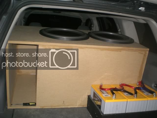

It is 2 18" HDC3's in 11 net cubes tuned to 40hz with 180 square inches of port.
http://
Will get more pics up and try to get a couple of vids but the subs are nowhere near broken in yet, only been played 20 minutes. And they are stupid loud. Tell me what you think, I know the box is not the cleanest or best looking but I am still new to box building and I am not that interested in looks. However it does slam hard.
you even said there not broken in yet so flexing prolly will happen no doubt it get crazy loud but that a shit ton a weight on a little piece of MDF
what kinda SUV are they in ?? proly tearing that bitch apart
thats exactly what i was thinking when i first looked at the box, it looks like 1/2 inch MDF but im sure its 3/4. you def need a double baffle. but it looks good otherwise.
and it doesnt look like there is any screws, i may be wrong, but i would put hella screws in that box. cause i see that thing flexing like a motha fvcker once you really start working those drivers.
screws aren't extremely necessary but in his case i would have cause its not double baffled if it had a double baffle if would be more than sturdy enough to not use screws
Wood Glue > Screws
The screws are only used to set the glue properly. If he was able to hold the pieces together properly otherwise, it's all good. Although I think I see evenly spaced indents along the top edge of the box?
