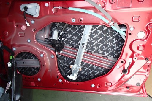

The attached PIC is the idea of the door skin lining I am referring to.
I then would like to seal the doors like in the 2nd Pic.

sound deadening can get expensive. i'm curious to see what other people think of noico 80 mill butyl. it probably wouldnt work too well for competetion application but for 1000w it would do well. my mid bass improved dramatically.
its 67 bucks for 36 square feet. butyl aluminum no foam layer. if you just want to dampen vibrations it should stop most rattling and increase output.
noico also sells adhesive backed closed cell foam layers to roll on top of it if you want to dampen outside noise as well as vibration. i think its like 50 bucks for 36sq ft of the 150mm and 50 bucks for 20 sq ft of 315 mm foam.
