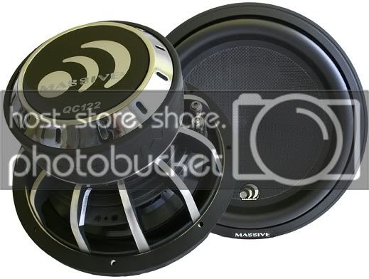

[headbang] My speakers are: Massive Audio QC 122 [headbang]
