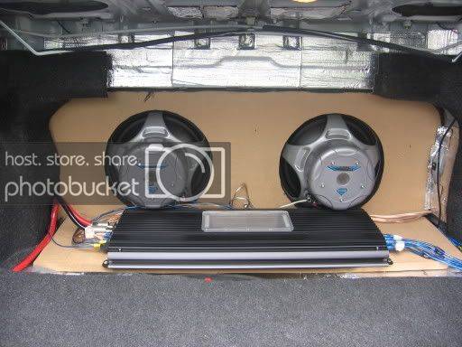

Second, IB is really simple. You want the front of the subwoofer COMPLETELY sealed off from the front.
^^Essentially what your aiming for. Seal up the holes in your back deck as well.

Yea, the bluewaves are well known as good IB subs for car. But if you already have an idmax, I wouldn't change it for bluewaves. IB is essentially open air, so you wouldn't want to seal up the trunk. Like Camry stated, it's more about sealing the trunk from the cabin. You actually don't want separation from the trunk and the outside environment
