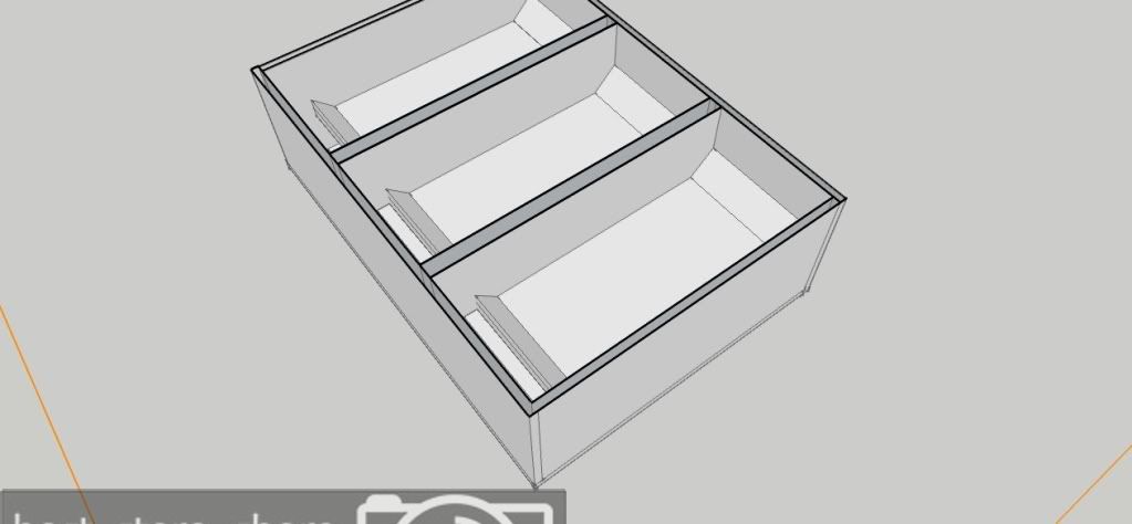

Brought to you by Decaf Inc. in accordance with Scapelli Productions lol. Design is for 6 SA-12's
10.38cuft@30.56hz or 27.37hz
44w X 23h X 32d
164 or 129sqin of port... 15.8 or 12.33sqin per cuft
f3 of 26.93 or 25.34hz
I was told there would be phase issues. Why do I find that hard to believe? Seems to me there is plenty of room in there, just because 6 subs are next to each other doesn't make it bad.
naa, shouldnt be phase issues. Maybe sound quality will suffer a tad with one common chamber vs. individual, but obviously thats not a set up for sq. Should wang hard, do it.
