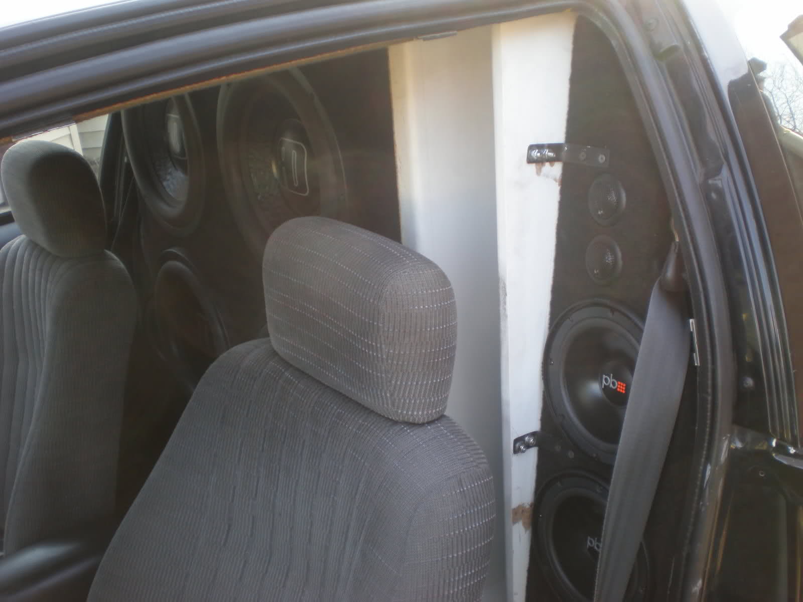

Box is closer to 8cubes now with the extra subs and bigger port. Tuned around 33Hz with 126^2 of port area.
Box was built outside the car and carefully put into place. BFH and 3 guys beating the shit out of it and it finally fit.
I was quite impressed by it today when we got the comps done and played with the gains/EQ settings. Michele wasn't so impressed was she Jake //content.invisioncic.com/y282845/emoticons/eek.gif.771b7a90cf45cabdc554ff1121c21c4a.gif
Moves some air for sure and he should be able to pound on it for long periods of time without hurting anything. Well other then his clapped out car that's falling apart...
