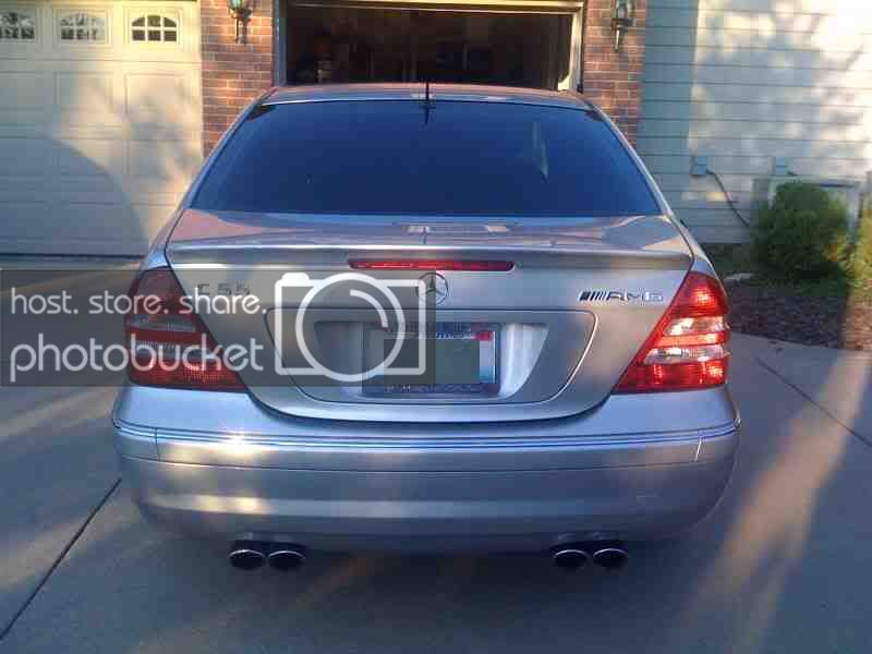

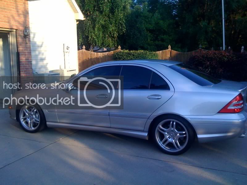

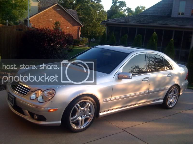

Car- Mercedes C55 AMG 2006

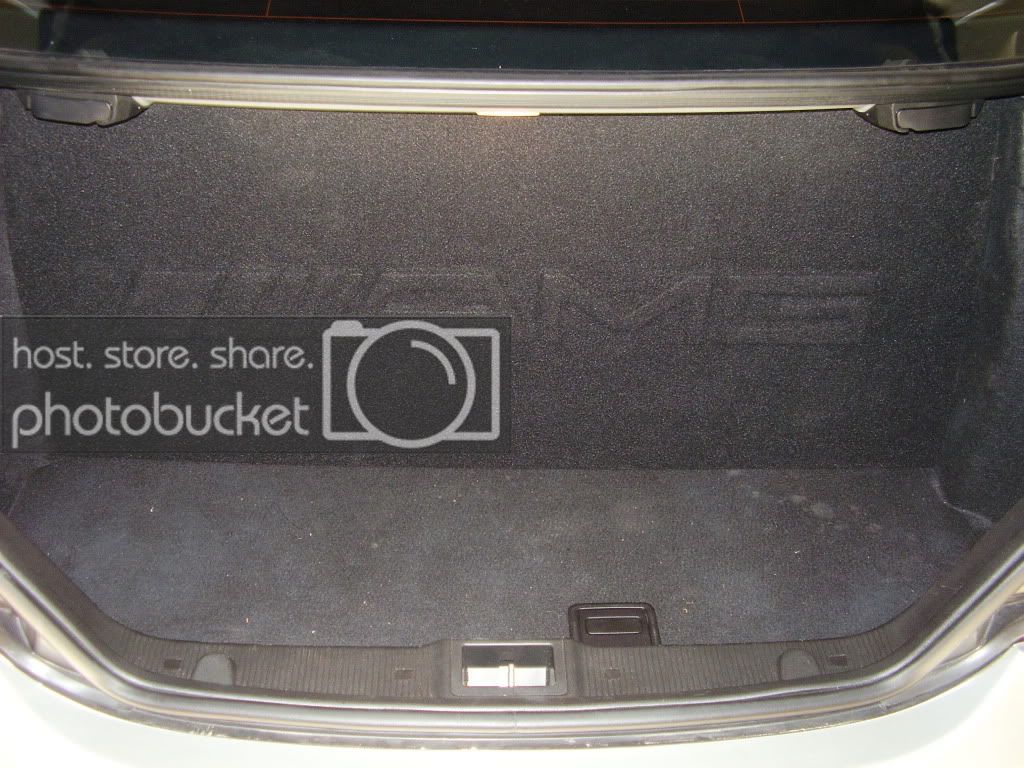

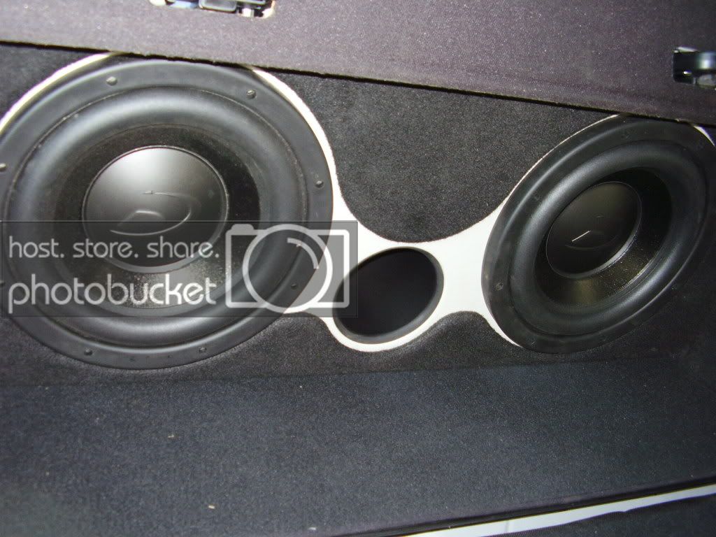

Subwoofers - 2 Dayton Audio MKIII 10s
Amp - Kicker SX650.1

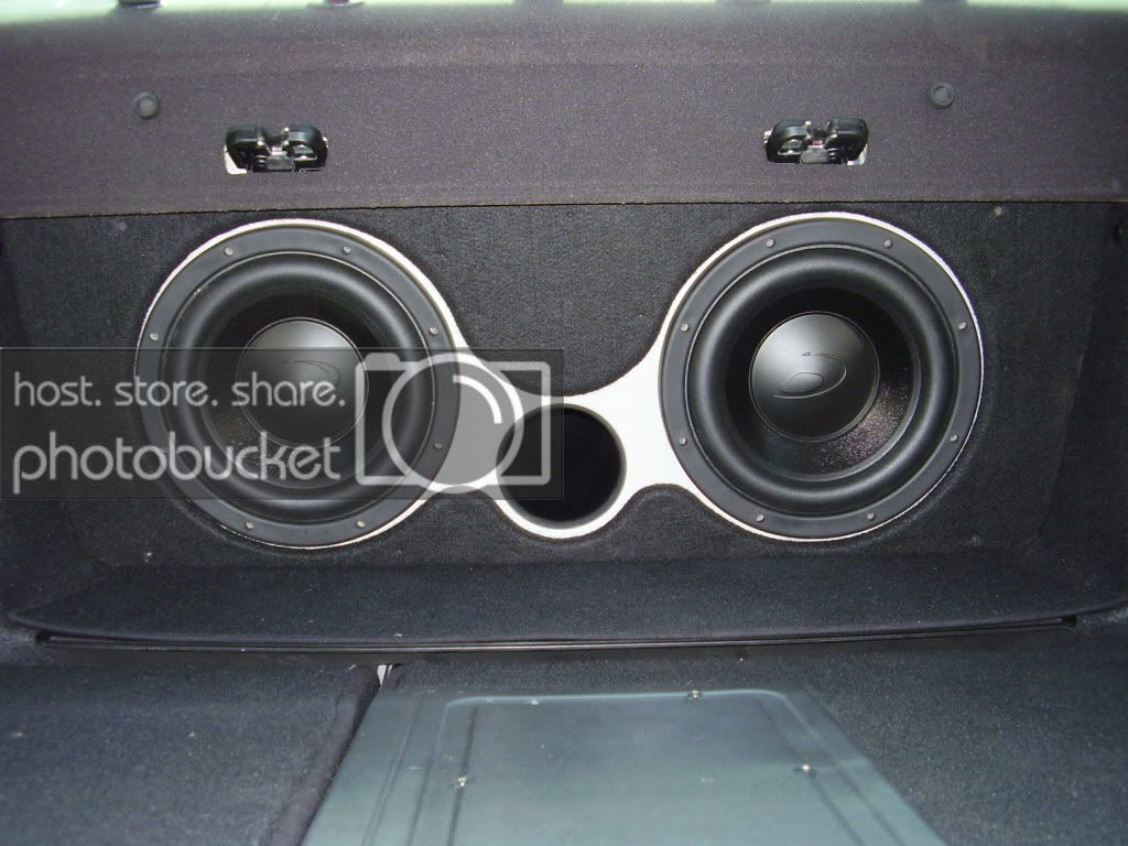

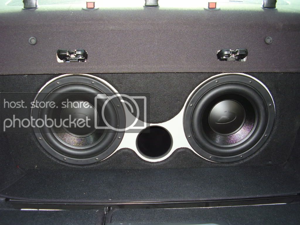

Box Information...

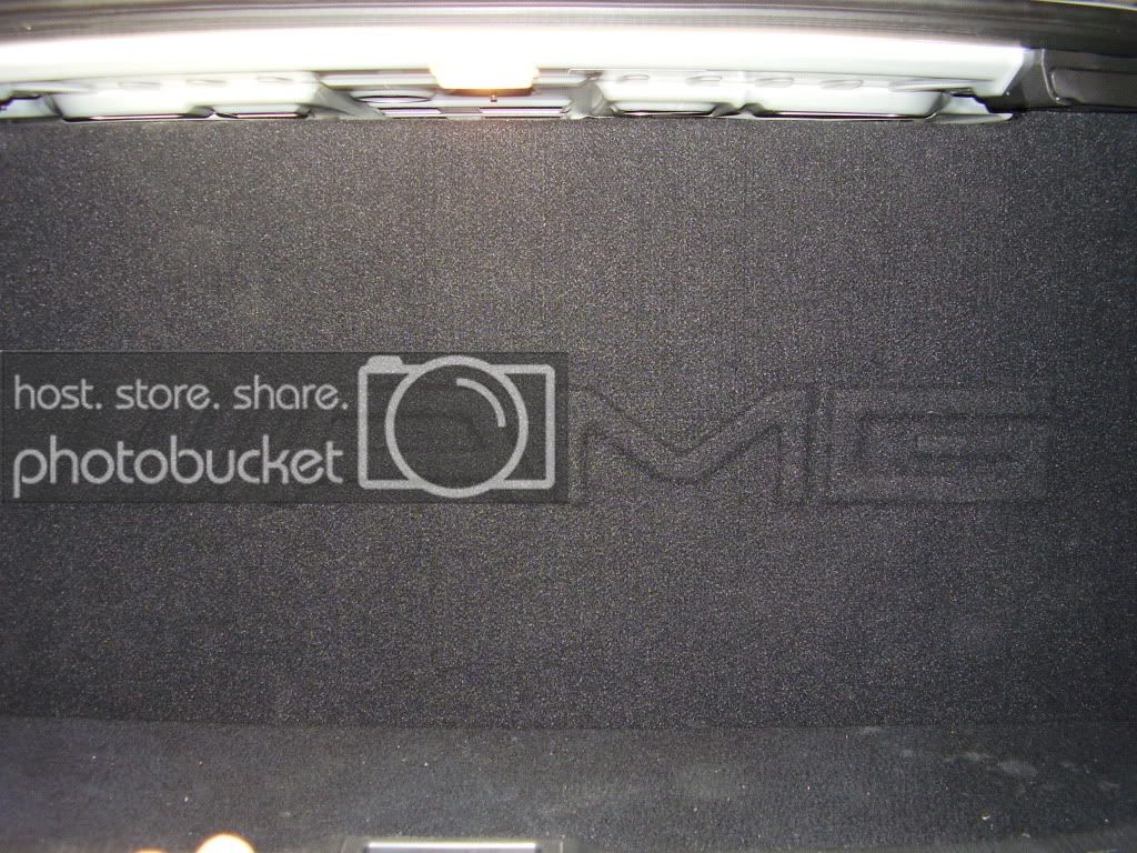

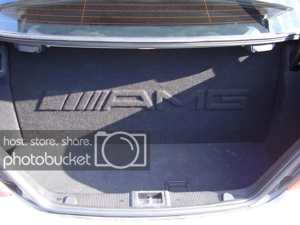

Box Volume - 2.54cuft

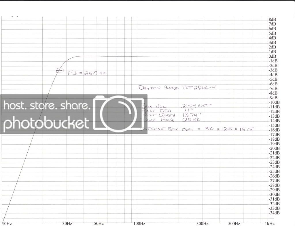

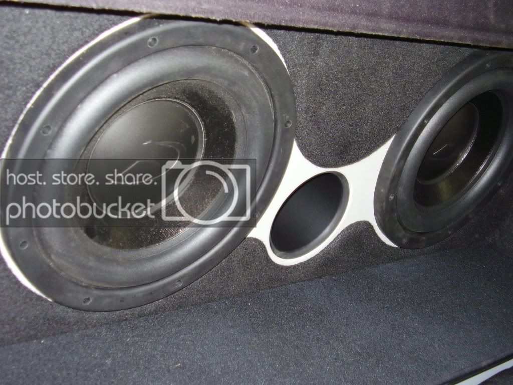

The box has a single 4" aero port and its tuned to 28hz. The box was to shallow for the correct port length so it has a 90 in the back to get the full length.
Heres a pic of the WINisd graph
The F3 is 26.9hz and it stays extremely flat, very happy with the curve.

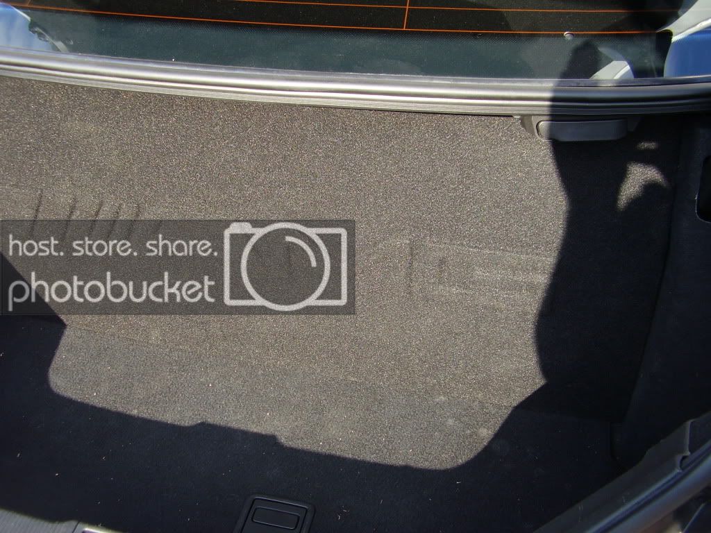

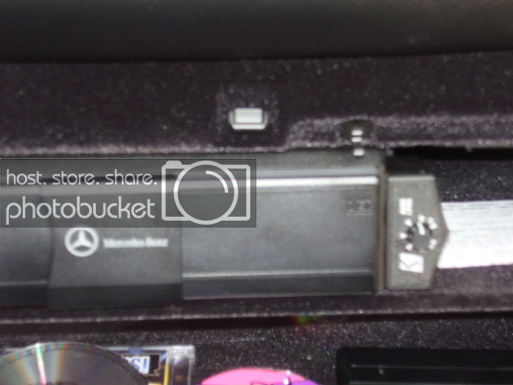

Heres some pics...
First review of the box is positive. Extremely clean and accurate on almost any music Ive tried so far. You get the lows with R&B and when I tossed in some metal the double bass was perfect. Ill do a full write up after a couple of hours of tweeking and listening.
I will say I was hoping for a little more SPL.. but then again my previous smallest system in the past 3 years has been 2 15s off 3k. So its a HUGE downgrade in bump.

Dayton has some accurate subs here... I'm blown away on how clean they hit and how well they blend with a LOC, stock HU, and stock frontstage without any EQ. The box, which is designed to be as flat as possible, seems to be responding as well as I hoped it would. I'm letting the subs loosen up a little today by running some sweeps at very low volume. Hopefully in a few days they will be great.
