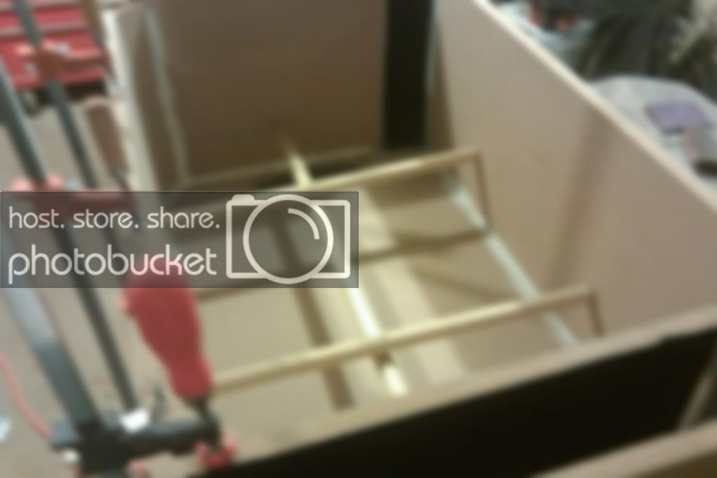

bracing a box will keep it more rigid which means less energy is being used to flex the box, and more energy is being used for output. You can do it multiple ways, I use wooden doweling but you can use threaded rod or some people even take a piece of MDF and use that to brace it all. It's just something to connect walls and make it sturdy.
that's my wooden doweling bracing.
then threaded rod would be a steel rod with threads all the way through doing the same thing.
