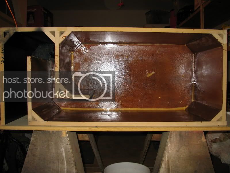

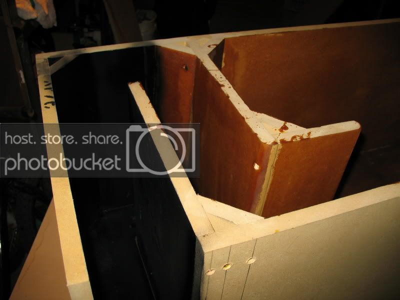

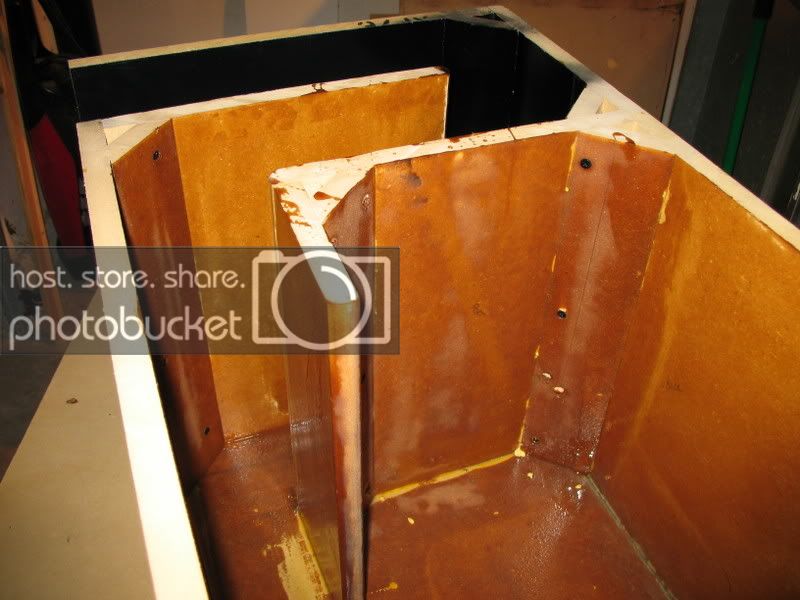

Needed a new box, so it was time to get to work. Box is for a 15" TC 3000(for now), designed by IonSQL. Its 3.5ft^3 @32hz with 60 sq.in of pot area. Tried a few new thing this time around like rounded over port walls, 45s in corners, and resin the inside. Enough talk an onto pics.
