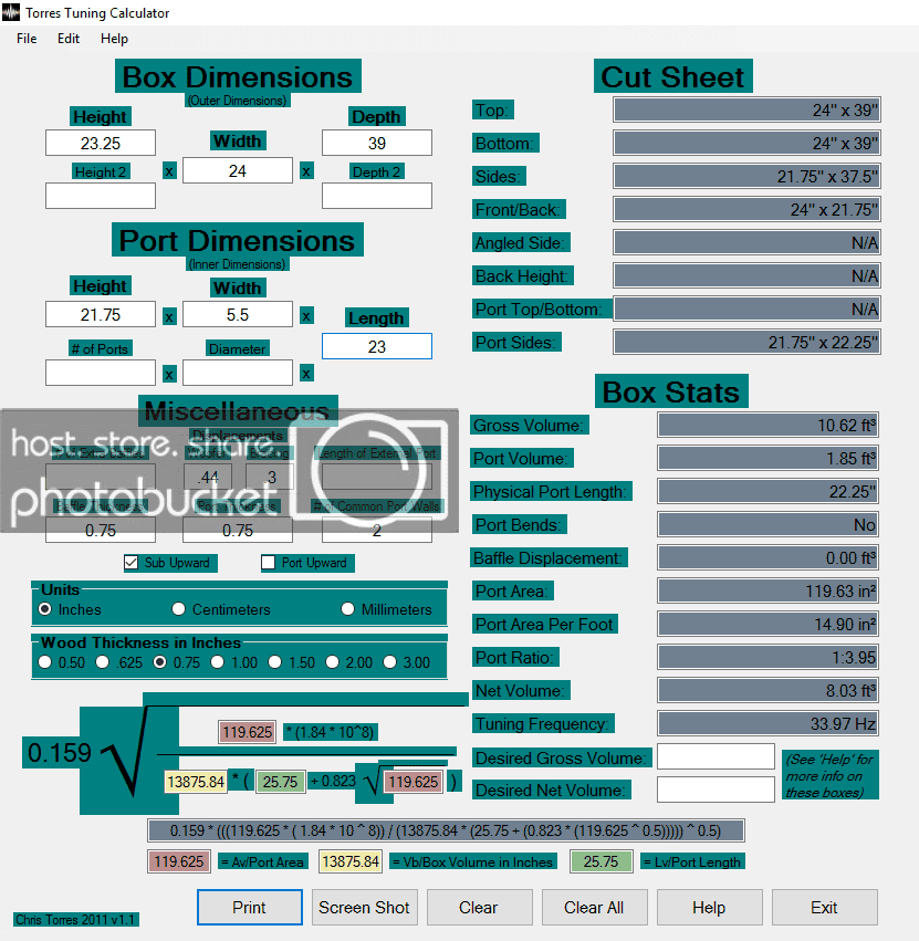

This is a plan for my new box, I love mine now, just seems like there is more potential. I love my tuning, I don't like many things below 30hz but I do like my 36-40hz range. It will be double baffled at the top, just never put it there just to make things easier for me. Does this box seem viable or should I do more port area?
