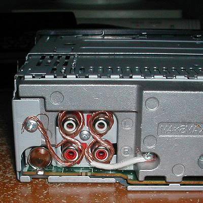

Excellent! Now try moving the ground to the amp itself. Also re do the ground for the amp making sure it is indeed grounded well.
Thanks and I will try it (ground to the body of the amp).
I am also going to see were the factory grounds the battery to see if I can improve that. I am also trying to get my hands on a lowner capacitor to see if that does it.
Boy my Son is going to owe me for this!!
Thanks and I will try it (ground to the body of the amp).I am also going to see were the factory grounds the battery to see if I can improve that. I am also trying to get my hands on a lowner capacitor to see if that does it.
NO Ground to the amps ground terminal.//content.invisioncic.com/y282845/emoticons/wink.gif.608e3ea05f1a9f98611af0861652f8fb.gif
do this to the HU, then plug in the rcas.
