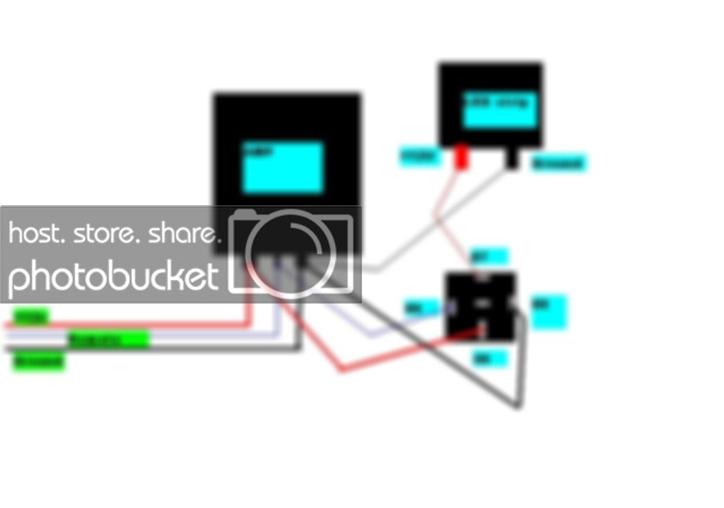

The easiest way to do it would be to wire in a relay at the amp to turn on the led's.
It isn't pretty but I threw together a diagram to show you what I mean.
The diagram uses a BOSCH style relay like this one.
