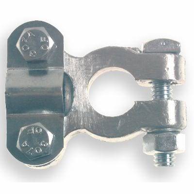

Go to the autoparts store and get a "Heavy Duty - Truck Style" battery terminal.
You will cut your old one off, strip the end of your factory battery wires, and stick them under the clamp. There are 2 bolts on top that you tighten down.
Real easy.
