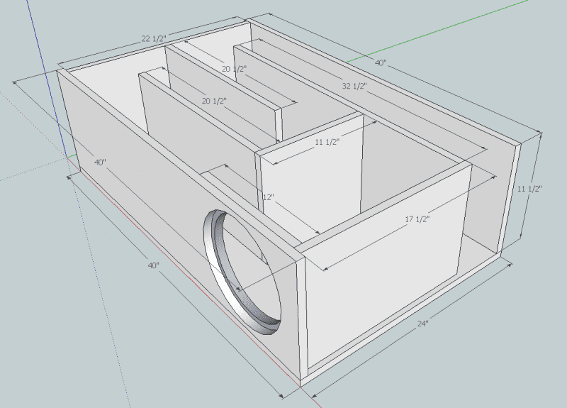

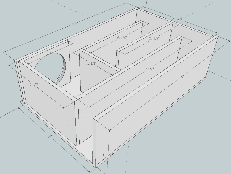

how do you figure the size for the chamber loading style? Ive seen several, but the owners could never tell me how they or the designers came up with the size for the chamber?
mean free path is 119.75 inches or a cvnt hair under 10ft. that puts 1/4 wave tuning around 28Hz.
the rear chamber can be made smaller by filling it, and maybe that'll be a way to "tune" to your tastes. a 1/2" lip around the enclosure should be added to leave a carpeting lip.

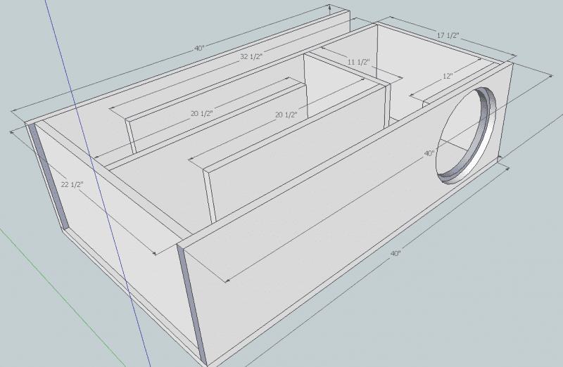

i made two other versions, one that was 44" wide and another that had an incorrect carpeting lip. final version is below (missing 45's)
there's the carpet lip properly laid out.

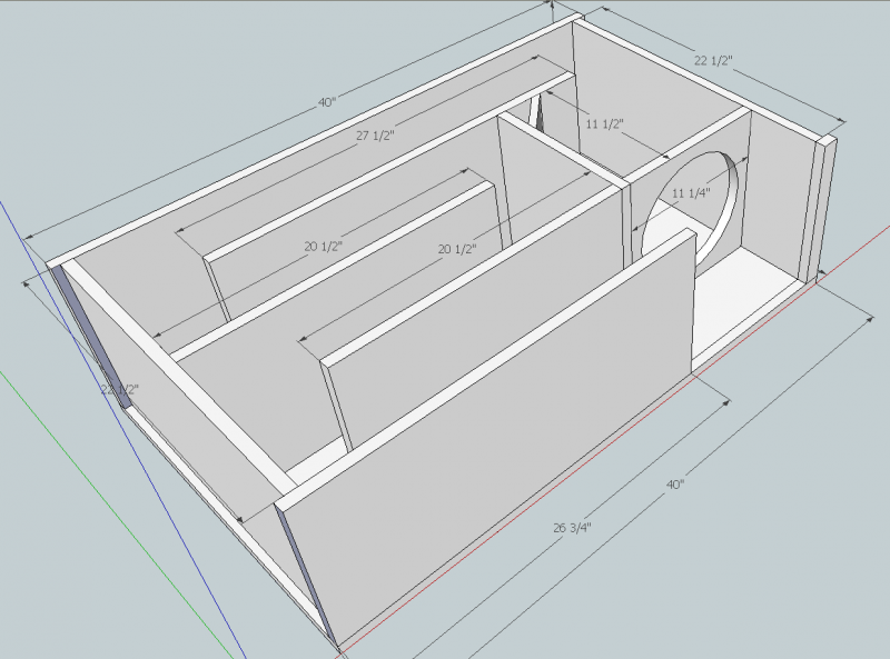

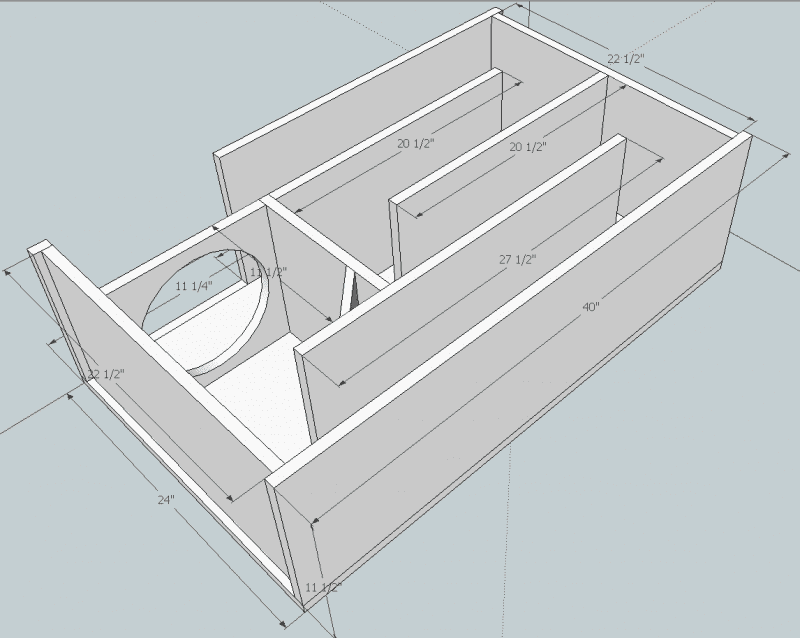

I'm gonna have to build this next.what would an ideal sub to use in this on 1000-1500 watts?
this is the type i would build next. get the TL output to couple with the woofer output. also, this allows the chamber to transition to the TL better. same dimensions and nearly the same tuning. with this design, you want a woofer with an fs around 28Hz.
Can you give a quick review of how this differs from a standard 1/4 wave
it's not different than a standard 1/4 wave, it's just a version of a 1/4 wave. the challenge is how do you get the woofer output to enter the line effectively. with a shallow woofer you could eliminate the enclosure completely and gain line length which would lower tuning. if you had a 10" shallow sub with a fs around 20Hz, the same dimensions would work with the line the width of the box four times.
How would this work. If you say good I'm doing this
