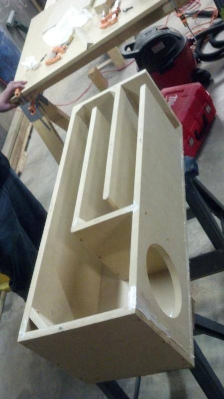

this is a TL for one 8" tuned to 42Hz i did recently.
partial construction. had some more 45's and a double thick front baffle at the end.
Is that a p2?
