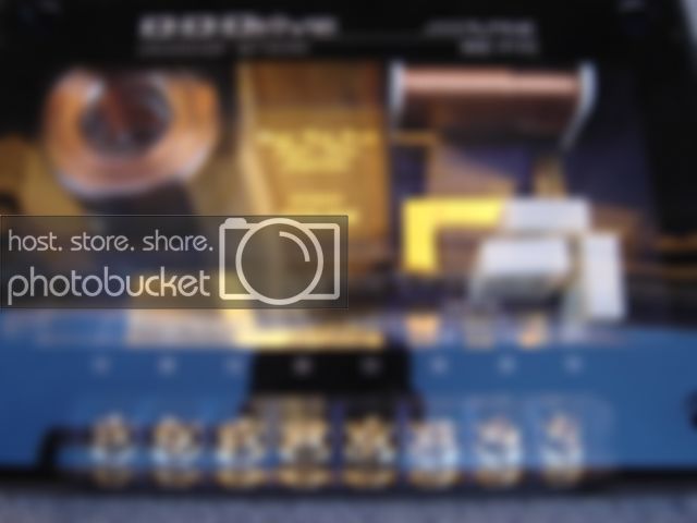

Ok... When you buy a comp set together, it will come with a crossover... The speaker wire off the amp coming in to that door will go into the crossover (input), then out of the crossover there will be a + & - for the mid woofer & then another set for tweet.. Of course they are crossed different.. see pic..
Well I was going to hook you up with a wiring diagram but I cant find one that will make much sense to you. Just trust us, get a good component set, it will come with crossovers and have instructions on how to properly hook them up. As for a recomendation, for your broad music taste I would recomend Hertz. But honestly you need to go audition some and see what you like.
