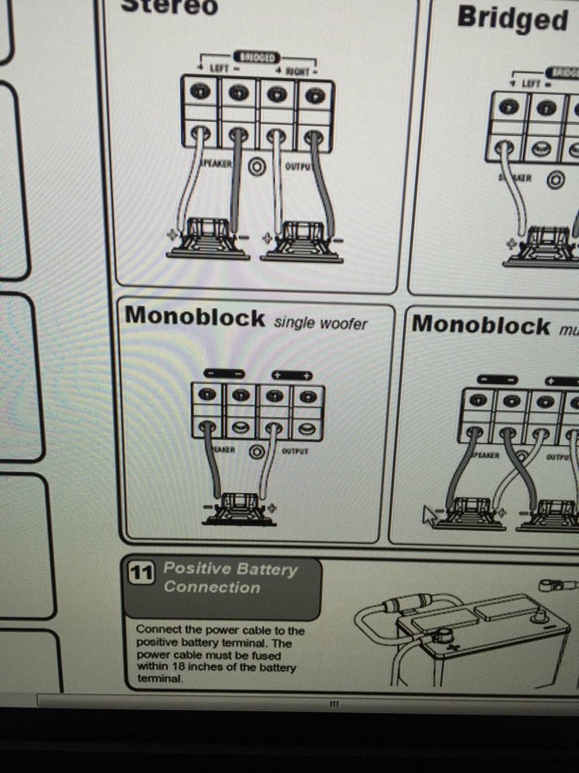

I just got a new amp so I'm not very familiar with it . The amp is a hifonics zrx-2416.1d and my subs are dvc that are now wired together to 1 ohm. The amp has two inputs and this where my uncertainty comes in... the 2 subs are wired together as 1 at 1 ohm and the amp has 2 input terminals in the manual , see this picture below:
So if I'm correct , I would wire them monoblick single subwoofer since both of my subs are wired as one and the amp should acknowledge that it's a 1 ohm load and throw the watts of a 1 ohm load at my subs , right ?
I take it I'm set up ok, things are bumping hard and heavy
