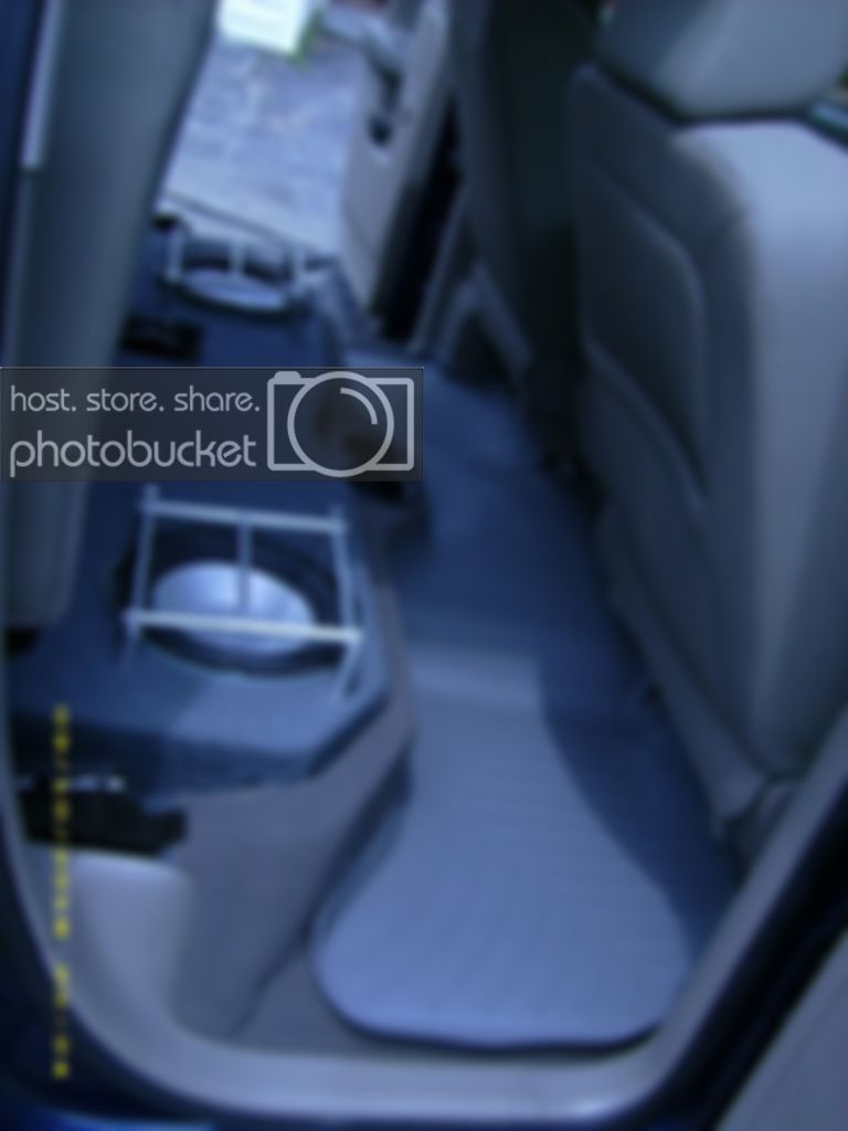

I have 2-10" Infinity Perfect running off a JBL/Crown BPX1100.1 amp. Those are super clean, but are x'd at 50hz so you can't pin point the bass.
