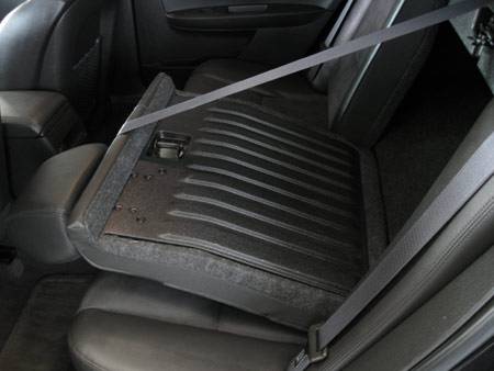

I'm trying to gain a bit of trunk room, and increase sq a bit while I'm at it. I am considering building it to fit flush with the trunk pass-through opening, and have the sub behind the larger of the fold down seat-backs. That way I can always have that one down, and have a usable seat.
Different car, same seat/location^
Would that be a good idea? I can't seem to get winisd to agree with my crappy desktop. Even if I could, there's too much knowledge/experience around here not to ask.... What would be a good volume for a sealed enclosure. Vehicle is a 2005 Malibu.

I know I'll lose some output going sealed, and I can deal with that. I am more concerned with gaining space and having an enclosure that can maximize sq, while still remaining loud enough to keep up with a fairly stout front stage. As much as I love the way this combo gets super low and loud off of relatively low power, it takes up the vast majority of my trunk, and I need some of it back. I may be mistaken, but i was under the impression that loading off of a corner/wall/etc changed the response curve, and I'm looking to make it more even. From 30hz up, anyways. It seems to heavily favor the 30hz zone, and taper off quickly after 40.
