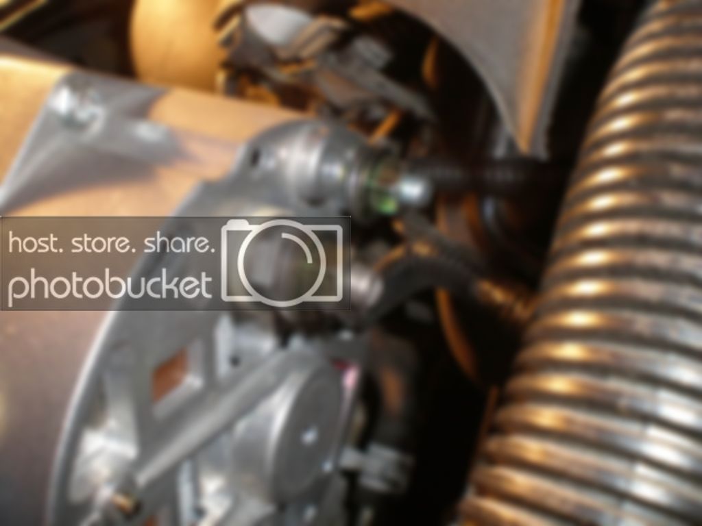

Just trying to be safe rather than sorry. My Ho alty (mechman) has two bolts on it, one is labeled battery, the other is not labeled. Is this second bolt a ground? The stock alty only had one bolt //content.invisioncic.com/y282845/emoticons/confused.gif.e820e0216602db4765798ac39d28caa9.gif
im guessing its a groundit isnt labeled to?
nope.
I emailed mechman a while back for installation pointers. He told me to make sure i ground it with 1/0 straight to the frame for best results.
sssoo, im going to guess it has to be ground, seeing the other is positive, and the only other bolt spot ( other than the mounting spots, which are grounds already) is this one bolt in discussion.
I was just hoping someone could give me a definitive answer hehe
It is a grounding point. I would double up on the 1/0, and also ground your battery there. Be sure to ground directly to the frame, and if you do not have a chasis then ground to the layered sheet metal of your unibody and not a single ply of metal.
****, really? lol. Looks like i got a bit more crimping to do
