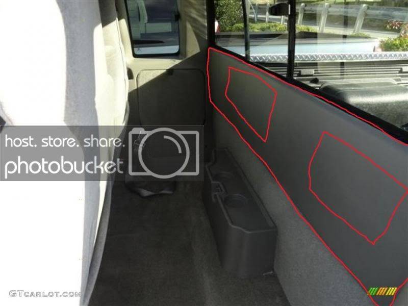

Now that you know what im working with here comes my plans/questions. Im going to be mounting the amps, crossovers, distribution blocks and anything else used for the wiring to the plastic piece below the window. Obviously as it sits its not strong enough to hold all the equipment so thats why this will be temporary until i can make it the way i want. Picture is not my truck just one i pulled off the internet.
