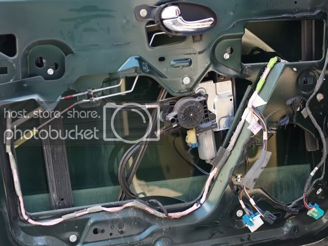

So off goes the door panel and this is what it looks like.
This black stuff is some sort of rubber sheet that was sticking to the door by some gung they put on.
Thats the door without it
some pretty large cut outs on that thing, makes internal access easier. Cleaned the door up using some carburetor cleaner, vaporizes quick and leaves no residues.

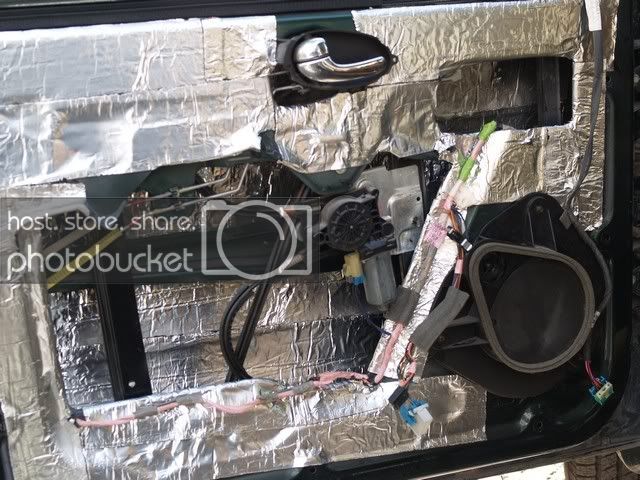

Next step is applying the tar foil, used some 3M 77 spray glue on top of the adhesive on the tar foil and on door surfaces, after some seconds it sticks really strong have to work careful to make sure it's not sticking to my fingers.

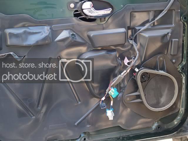

Put the rubber sheet back the speaker plastic mounting ring is actually sitting on top of it and reinstall th edoor panel and done. Used a 10 m by 10 cm roll for this
