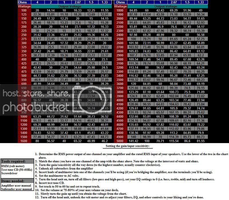

ok so i know theres threads about amp gains and i looked on them for the equation BUT i just dont get it.
ok so imna be running a Hifonics 2608D so lets say 2500x1 would be 2500 (duh) and the sqrt of 2500 is 50? so do i set the gains till it shows 50volts?
The formula you need is P = V^2 divided by R.
Sooo... if you want 2500W on 1 ohm...
2500 = Vsquared divided by 1
2500 = V^2
So, V = 50
The V (Voltage) changes according to the ohms you are using. If using 2ohm, 50V is not the correct answer. If you nudge the gain up a little and the voltage doesn't go up, that's the top-end of your amp. Other than that, follow one of the standard threads on setting gains.
sorry i should of been more specific with what that x1 was
You didn't say how many ohms, so I don't know if you were right or not. Cool chart outspoken. That should answer his question.
OUTSPOKEN
thanks for the chart man now i know for sure im right.
