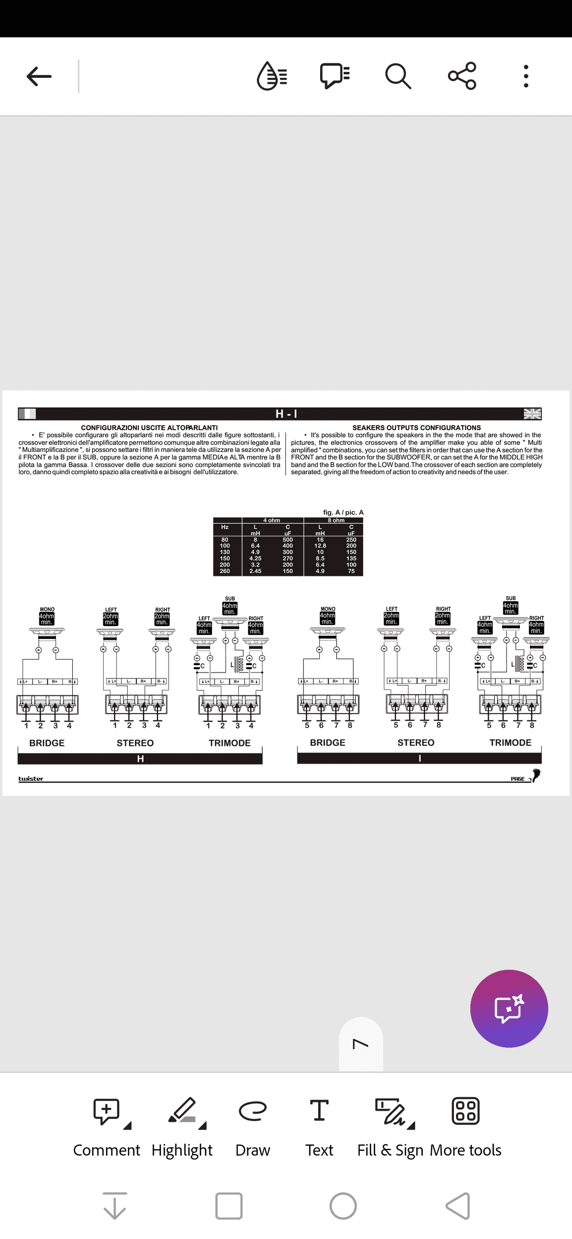

Check this out.

Dash speakers? bass blocking crossovers are for if you want to add a subwoofer to the preamp outputs of the head units. Not using an amplifier then. It will act as a high pass filter. Blocking deep bass from entering the two front speakers. So louder sounds can enter the subwoofer.
