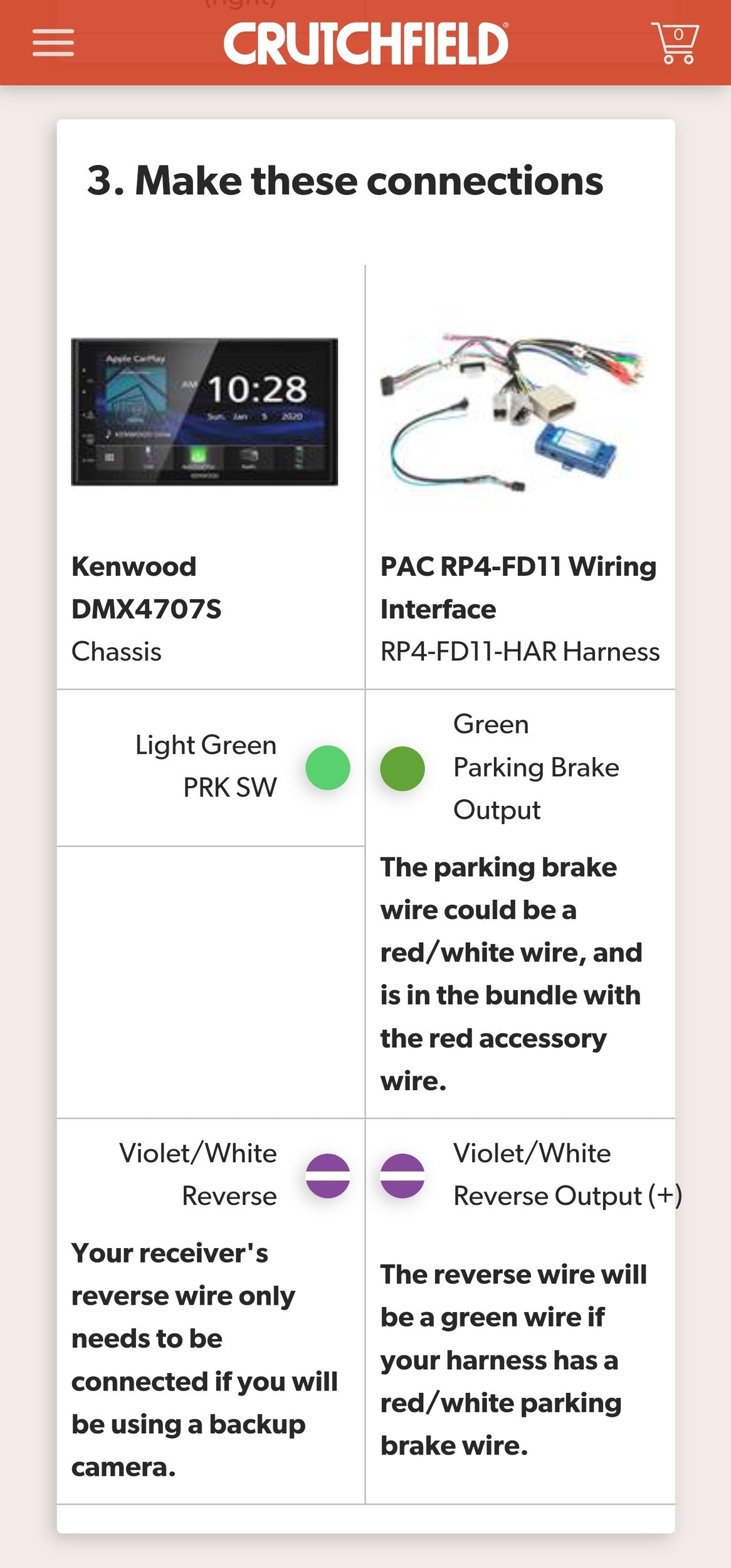

Also one more question those who have this unit or close enough, i noticed it needs to be spliced into the parking brake to access settings, i saw where you can ground it to the back of the unit. But also saw it causes issues *quick google led me to reddit.
How would i go about bypassing this just cut green wire on the head unit and ground it? Or am i missing something because the thought of using the e brake when im messing with it sounds stupid
Yeah you have it figured out. You can test if first to make sure. It's so that you can only input the GPS information while the parking brake is on (parked), because it's distracting to input an address, and therefor dangerous. Shops are going to connect it to your parking brake wire. If it's for you, have enough common sense when you do it, it doesn't become dangerous. If it's for a teenager, then you probably want it done the safer way.

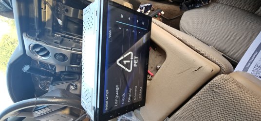

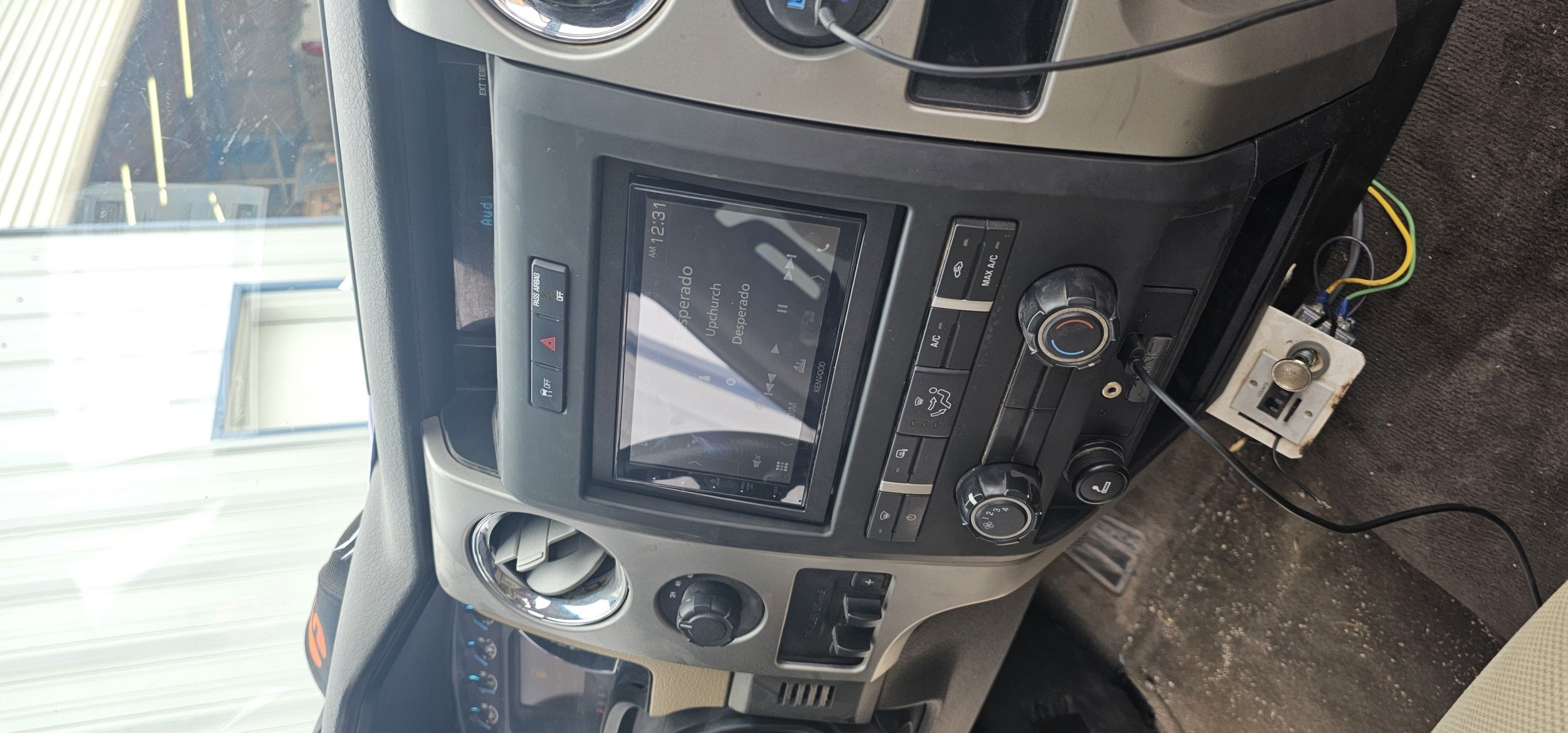

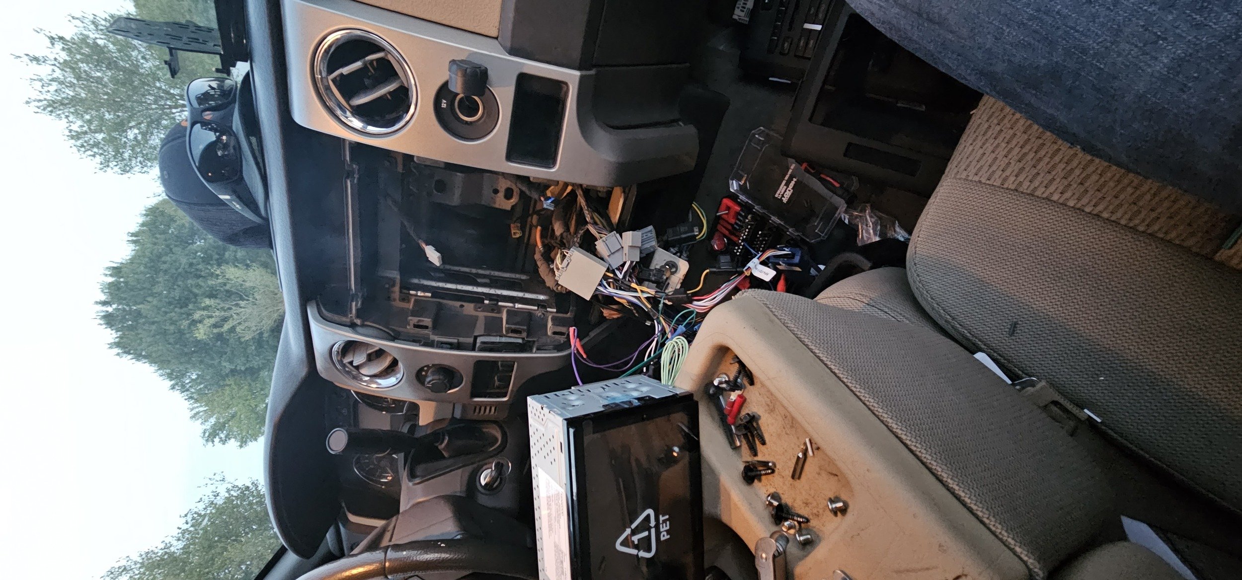

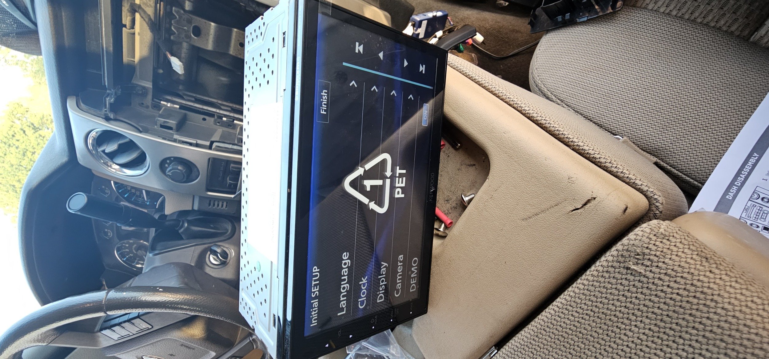

Well update time
Sorry for pics but android life. But clicking should show correct view
All 4 doors work and sound great, how im not sure as my connections look piss poor. *my biggest fight using butt connections.. i guess heat shrink tubing would be the best idea.
There is a metric ton of wires and half of them i don't know what its ment for. Tomorrow should have it fixed and factory installed. *edit a lot of them i probably won't use.
Also on this kit it says bolt mount to the radio but screws aren't long enough. You can see it on dash in second picture
I failed today but got a small win with it working
