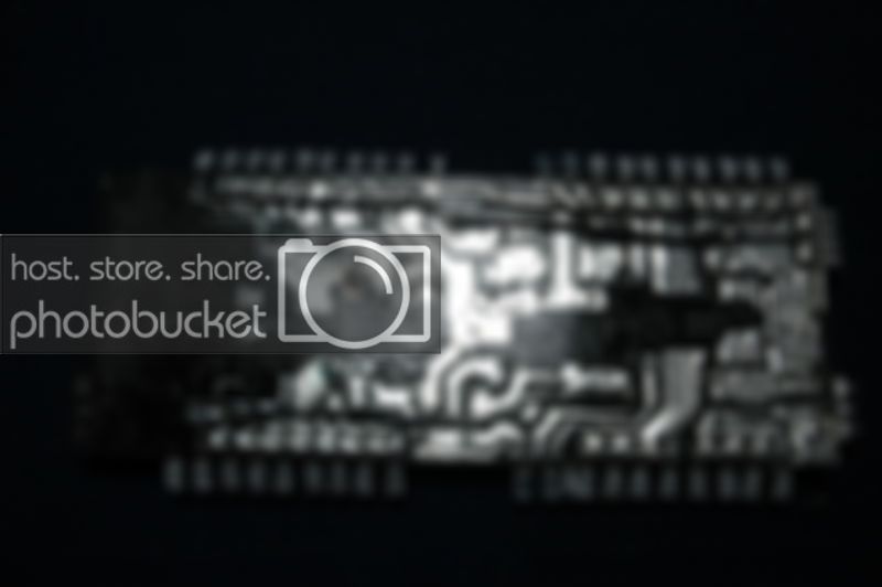

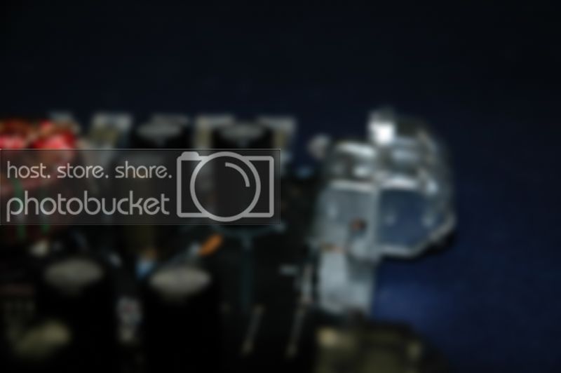

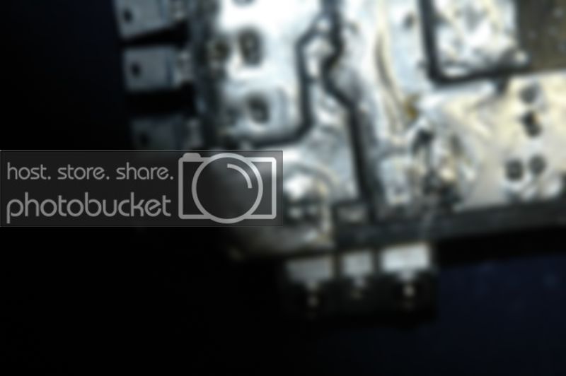

here are some pics with the heatsink off...
Nono, you don't need to power it up to test for continuity with the multimeter. Just put it on the >| setting and start touching things. Try any of the things you think to be blown that are in circuit. If you get a continuity, the likelihood is that they are good.
First thing I recommend doing, test continuity between the power and ground terminals. Depending on your DMM, it may beep, it may display resistance, it may just flash random numbers. All depends on the DMM, but I expect you to know how to use one. If you don't know how to use your DMM, post that and I will give better instructions.
Let us know if your +12V terminal and ground terminal give you continuity. //content.invisioncic.com/y282845/emoticons/smile.gif.1ebc41e1811405b213edfc4622c41e27.gif
