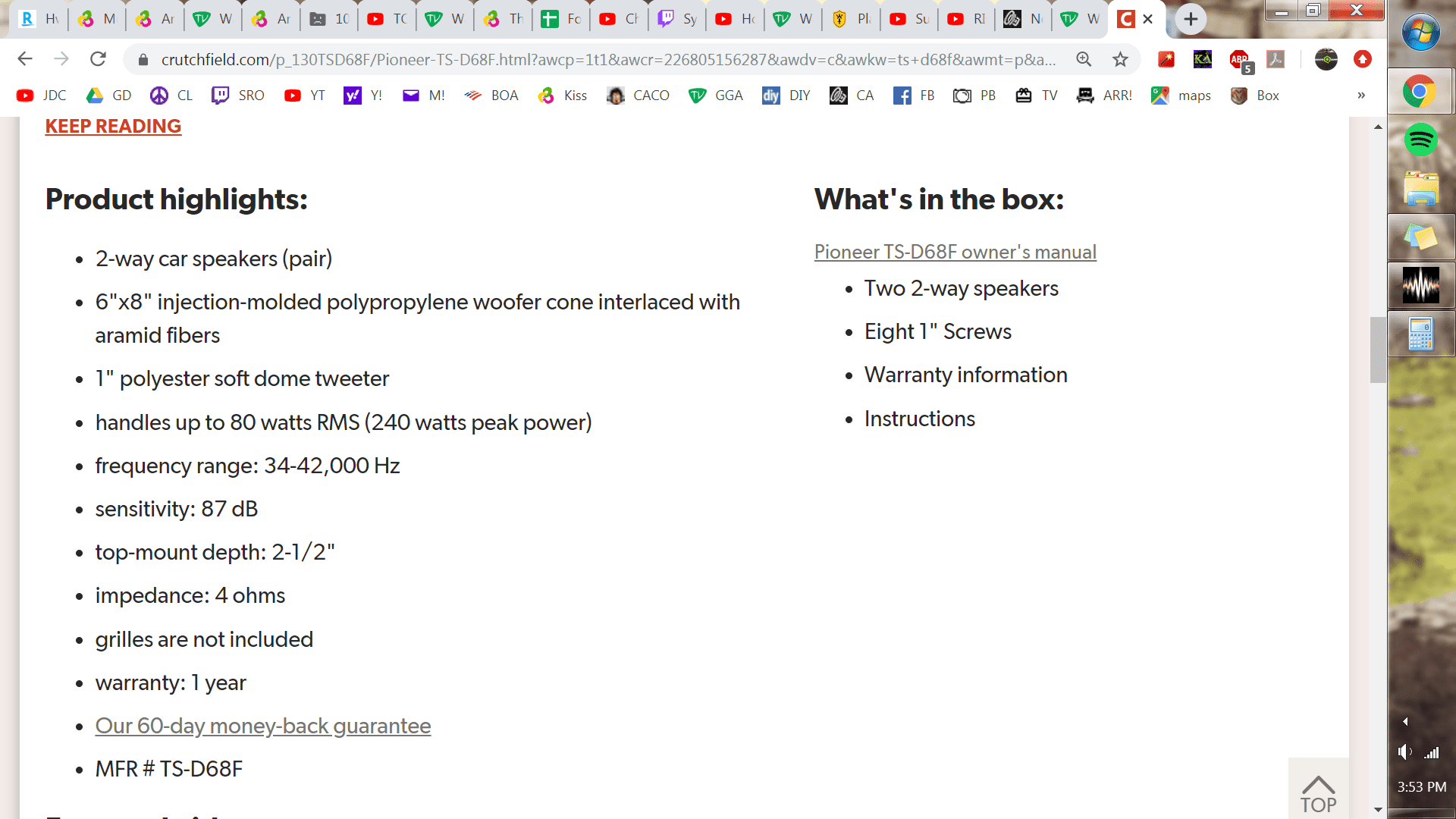

no, your speakers are pretty much at their limit. You need to look at sensitivity ratings when buying speakers. nothing else matters when it comes to loud, power ratings dont mean loud it just means how much it needs to get loud. Sensitivity is how loud it gets on the power you give it. shoot for anything 92 to 99 db sensitivity. Your current ones are 87 which is abysmally piss poor for a 6x8 which has a lot more cone area than a 6.5 and a lot of 6.5 coaxials are 89-92 db sensitivity. like a pair of 96 db drivers on 100 watts each will be louder than 16 of your pioneer speakers on 800 watts total is how drastic of a difference sensitivity makes. Seen and heard a live comparison before lmao 8 pioneer 6x9s per door losing to a pair of pro audio drivers and super tweets ran active by far in loudness.

Thanks alot guys for all these information seriously ! Pointless to bridge them at this point Damn I will probably have sell these and look into the infinity reference since it's sensitivity is higher.i will look into it in the next couple of months geez I was getting to my next step of installing subs but I will have to wait I want my mids and high loud before adding the sub.thanks again guys!

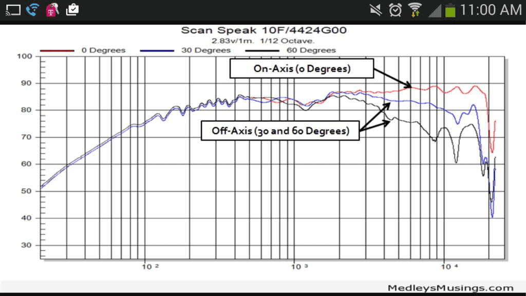

Its also missing details because you have the tweeters down by your feet. If you got some 6x8 components and mounted the tweeter up a bit firing towards your ear, you'll have better soundstage and clarity. But if you have to deal with coaxials, some coaxials allow you to tilt the tweeter so it fires up higher, make sure its firing as close to the direction of your ears as possible.

Gotcha ok I will check the settings.Ya that's true the speakers are placed lower so it does affect the sound quality but I still feel it's missing details to it.My doors are sound deadnend in the fronts only I might install some fast rings when I change the front speakers I will look into the jbl because the specs do look good 94 db sensitivity as well and like you said a little brighter then the kappa
it affects everything actually this is a frequency response graph on axis, off axis and very off axis, yours by the feet is even worse than that graph this is not your speaker its just a general example. On axis means firing directly towards your ear. Mids and tweeters on axis sound 100% different than off axis.
