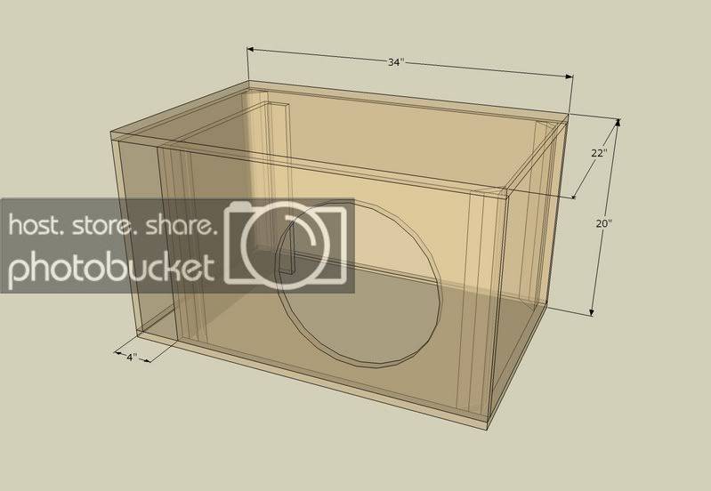

Need help for Box Design on a 15 inch Kicker L7
here you go 5.75 @ 33Hz w/ 74 sq/in of port.
