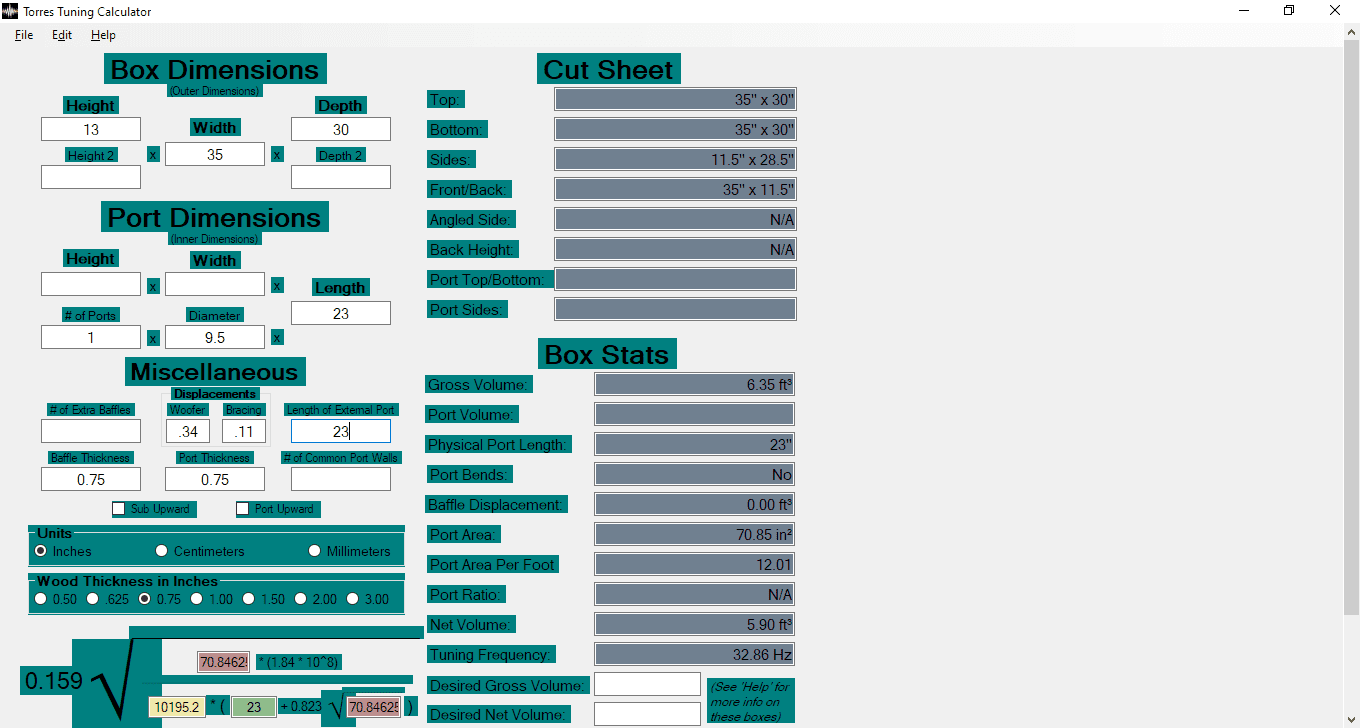

Even if your stuck trying to come up with something decent the best I could come up with is single ply & baffled, braced with dowels. A 9.5" sonotube (they are never all the same... so you gotta pick one) 23" long all external. Smallish airspace too. 100% not the best idea.
It'll be mufugly as hell but if you try something like this I take no responsbility. A forward firing port out of the trunk subs up/port forward is just asking for all knds of acoustic problems unless you have tested it 1st in THAT vehicle and know it works.
The bracing and displacements are neighborhood figures but close.

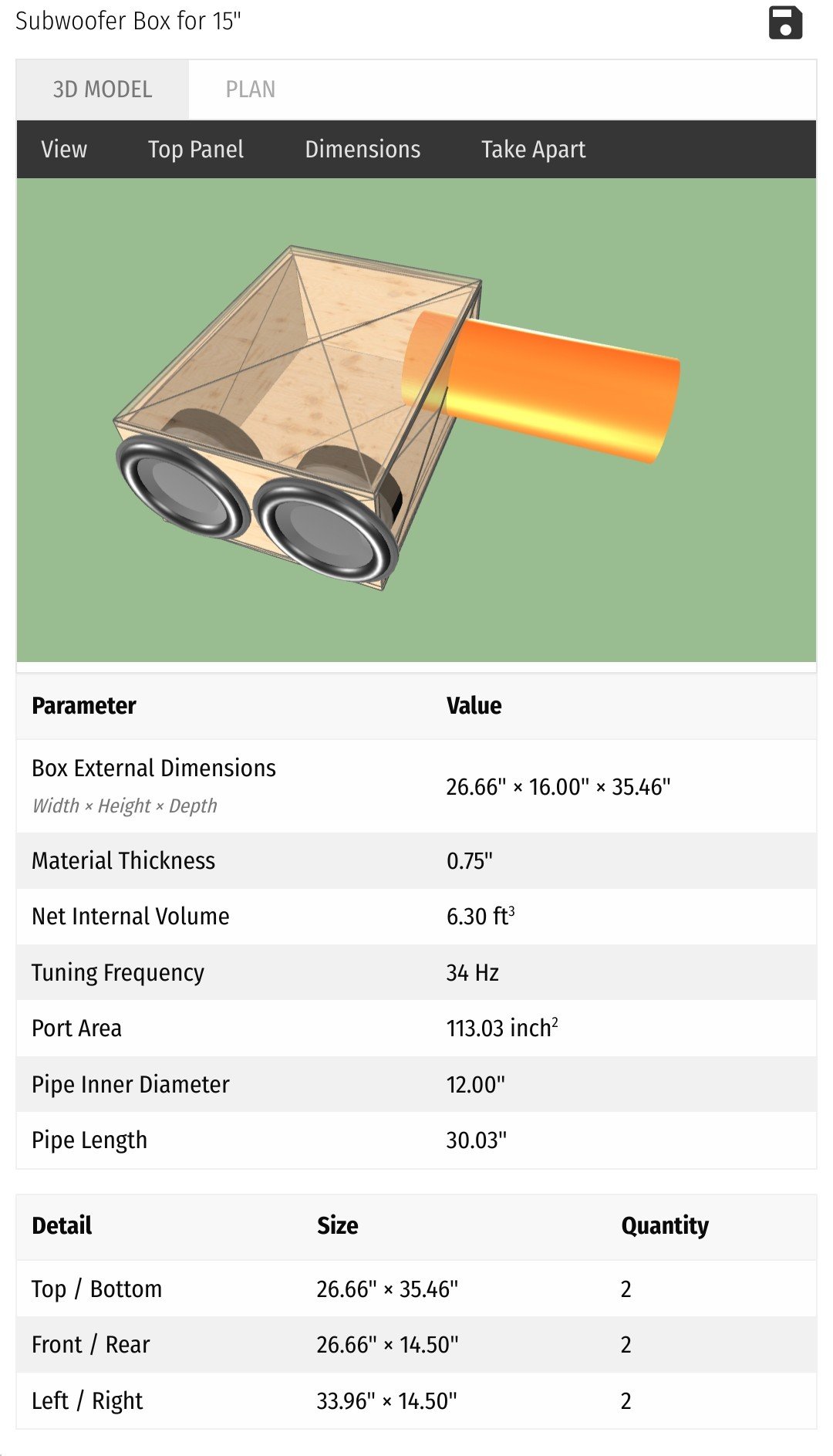

I think I can make this fit. How does this look if I can make the port work? Wondering if I should just scale the whole thing down a touch. Subs on side opposite of port double baffle.
I know this calculator *****. I'll finalize when I get to my computer.
