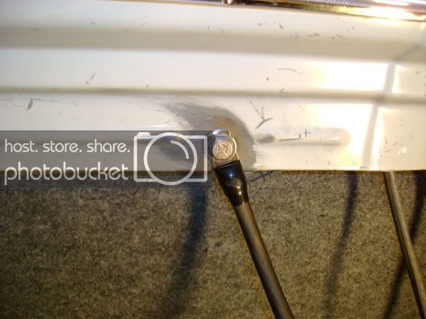

Heres a picture of my ground:
Where do you recommend? What you see there is on that back lip (where the seats rest on) in the trunk. Should i mount it underneath the carpet on the trunk floor?
yeah, that looks to be thin sheet metal...this is by no means scientific or provable but everyone says stick it on the beefiest metal you can.
cool, your on here...okay, what kind of car do you drive?
Try pulling out the floor in your trunk, to where the spare sit, try grounding under the tire there, or somewhere around there. If you have a drill, you can try drilkling and putting a bolt in.
However, another way to solve this stuff. Is, if you are grounding to body, not chassis, and the battery is grounded to chassis. Simply add a grounding cable from battery to body. Thus creating a second ground loop.
alright, i re-located the ground by the spare tire area. That actually solved my fluttering issue with the amplifier and speakers. Problem is now when the gain is more than 1/4 cranked and my deck volume is at 3/5 cranked, the speakers will start to crackle or pop. Also the ground loop noise is much stronger through the speakers now.
