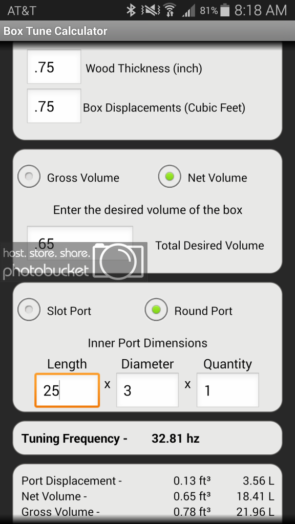

since it's so stinking cold outside and I don't have a heated garage, I'm going to try to modify a box I have now for the Sundown E8V3 I just got... box is currently sealed @ .75 cu ft. taking away the sub displacement it puts it around .65, per Sundown website ported this sub should be tuned to 32htz. so if I add a 3 in port @ 25in, I should be right there according to my calculations from the app I downloaded BTC... I'm just no sure I entered the values correctly... a screen shot is below... I don't know of the port displacement is calculated on that app in the final values, or if it just gives me the displacement values and then I have to subtract that value from the box displacement...
edit... also, in order to get the 25 inches, I'll have to use two 90° elbows... will that effect tuning?

It looks to me, on that app, you need to have your total net volume, including the sub displacement included in that figure.
right now you have a total of .78 cuft. which is just your enclosure minus the port area(.13cuft) for a total net of .65
if you know your box is .75 max right now, empty... you need to take that and subract your sub displacement to see what your starting net volume is.
You could always run your port external too, if you need the volume in the box ....
